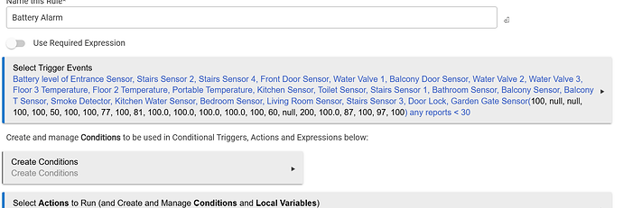

I have a rule to notify me if any of my battery operated devices' battery level drops below 30%.
Here's a screenshot of the trigger:
But I receive notifications when a device reports battery, even if the battery is 87%, or even 100%
What am I doing wrong here ?
I would remove the 'any reports <30' from the trigger and check the battery percentage remaining value into the Actions section instead.
Additionally, some devices lack a populated battery attribute (the value is null); verify how the RM handles this null value.
if I remove the <30 trigger, when(how) will the rule be triggered ?
The rule will be triggered on every device battery reporting.
Then, in the Actions section, add conditional IF statements to generate an alarm or not, depending on your battery level comparison logic.
ok but what is the way to "trigger on every battery report" ?
When value changes

I believe the explanation is this: your trigger will be evaluated with any battery report (even one of 100%). Then RM will check the condition, i.e. if any of the devices is <30, and if so, the trigger is fired. In other words, the device causing the evaluation of the trigger is not necessarily the one that satisfies the any condition. You can get around this by having one trigger per device. Agree with @kkossev you’d have to see how those nulls are handled by RM.
