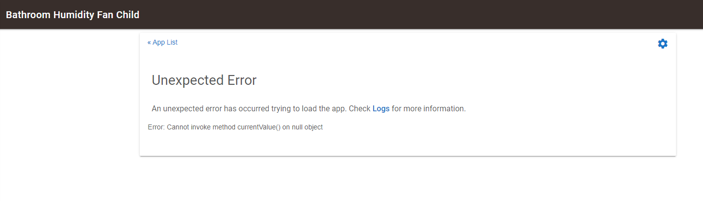

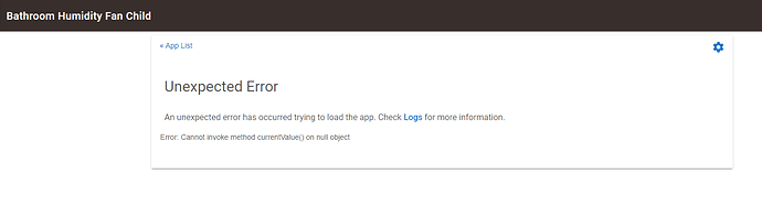

@napalmcsr / @lewis.heidrick, finally got around to try this app, so installed it via HPM. Added the parent and clicked done, go back in the parent to add a new Bathroom Fan and I get an unexpected error right out of the gate.
Error message SCREENSHOT on app page
Error Message in LOGS
app:4602020-12-28 19:36:40.661 errorjava.lang.NullPointerException: Cannot invoke method currentValue() on null object on line 534 (mainPage)
Looks like it doesn't know the state of the fanSwitch. Try replacing line 534 with the following. It will keep it from erroring out and I'll take a look after dinner.
Can also comment out the line with // at the beginning of the line.
ifTrace("fanStatus: [FanSwitch?.currentValue(switch) = ${FanSwitch?.currentValue("switch")}]")
Ya I looked at it real fast, what I find weird is that this error comes up before I even have time to configure anything. It pops up as soon as I click in the parent app to create a new child. I don't even see the setup page, did not have time to look more than that (wife want's to watch some TV together).
Np, I'll get it sorted.

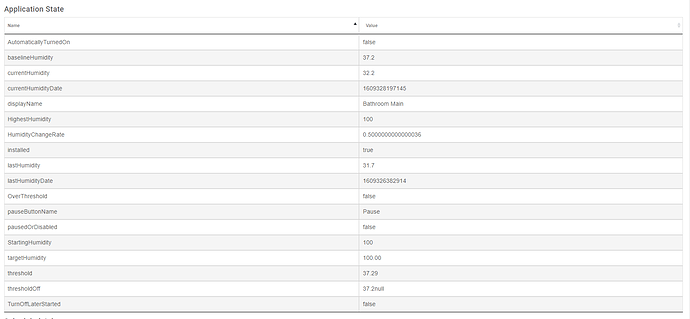

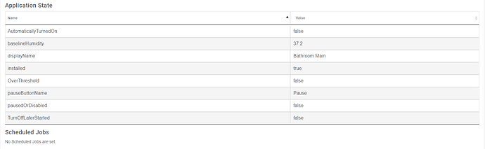

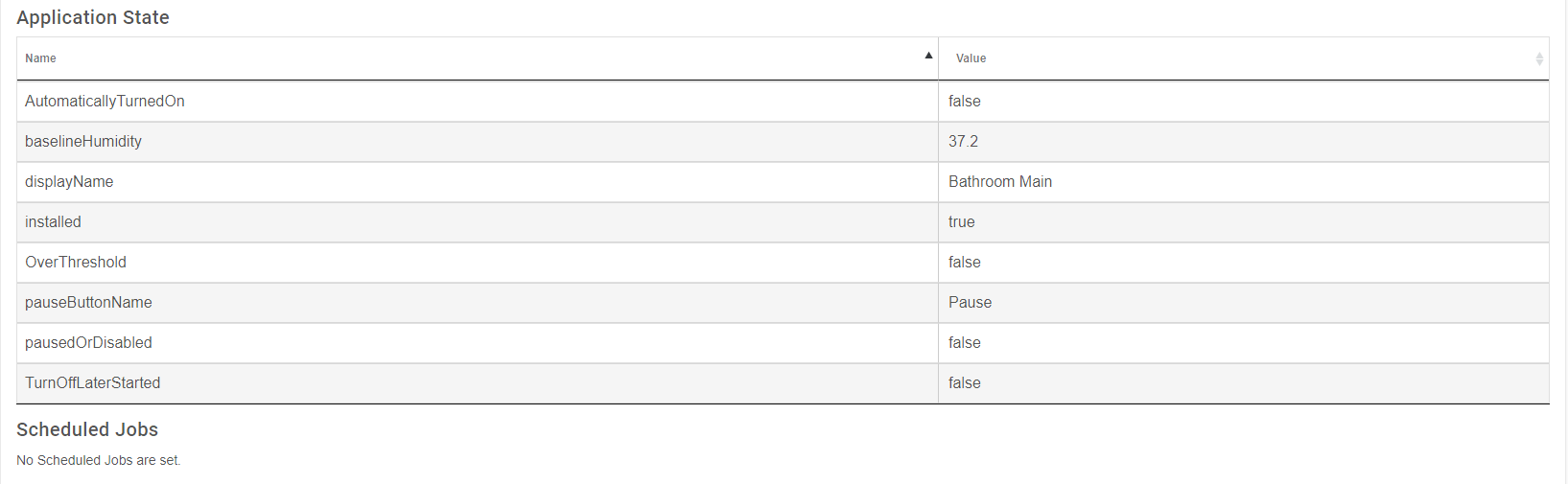

If you go to the child app in Apps and then click the gear at the top right and then scroll down to Application State, could you take a screenshot of the variables in there? Also, confirm that there is a humidity sensor loaded in the child app.
Line 233 is basically just a comparison between the humidity now to the humidity it was before to come up with a change rate. I can initialize the variable as some bogus value but that would just end up masking some issue you have with the humidity sensor not reporting the humidity.
state.HumidityChangeRate = state.currentHumidity - state.lastHumidity
Here is a screen shot of Application State, what I find weird is that in the debug lines up there, all Humidity related values (update time, value) are all Null ?
Might be the device driver I'm using that causes that, Konke ZigBee Temperature Humidity Sensor Driver
Just pushed out version 1.0.7. Able to reproduce the error now, let me dig into it.
Just pushed out 1.0.9 should fix it now.
ok testing, will let you know
Also, from HPM run a repair on the app.
How's the testing going?

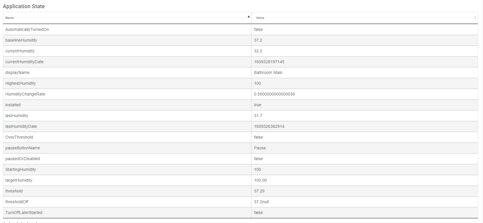

Everything seems good, no more errors, trace looks good, Everything is populating normally in the Application State.
LOG Trace
Application State

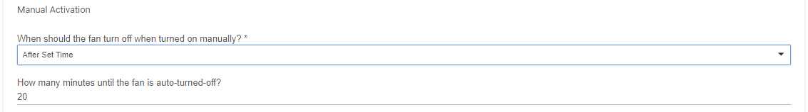

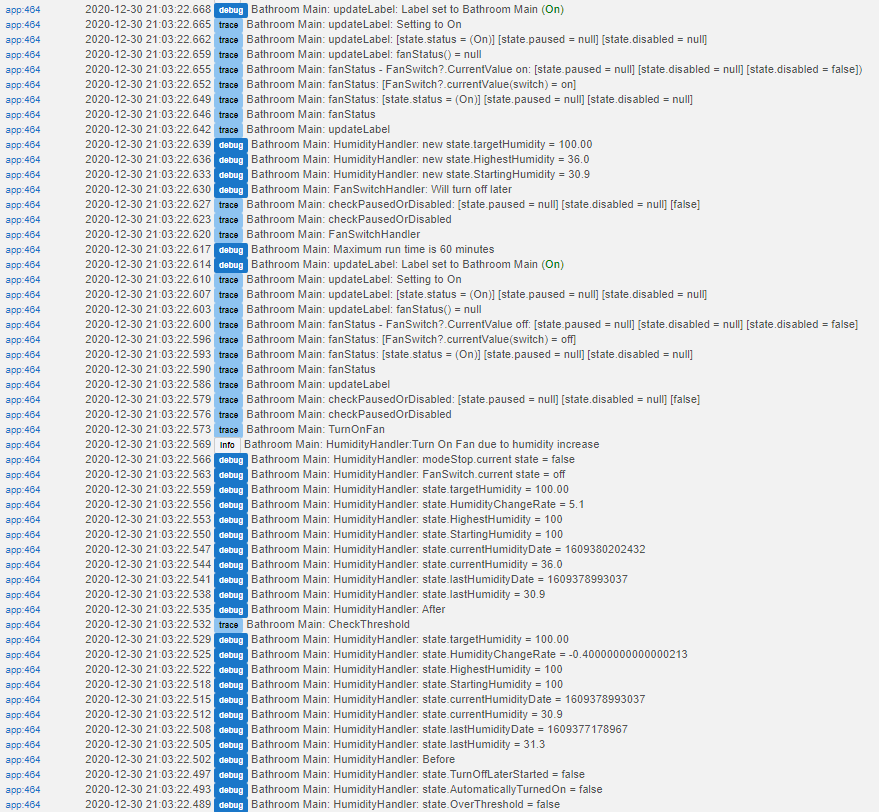

ok I think I found a small bug, the fan turned on automatically via humidity rise as expected, but then after the set amount of time (20 minutes that was set via the the manual switch option) it turned off, logs showed that it was turned off exactly 20 minutes as seen here in both cases we used the shower today...
I don't even have a switch set for manual yet nor did I install the internal fan switch either, reason why I'm using a virtual switch to test.
Here is the log trace for the turn on...
Turn on LOGS

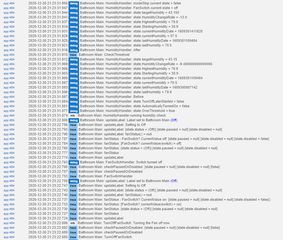

And where it turned off...
Turn Off LOGS
Unless I'm missing something, this should not have happened and should have stopped based on humidity or I'm not understanding this option.
