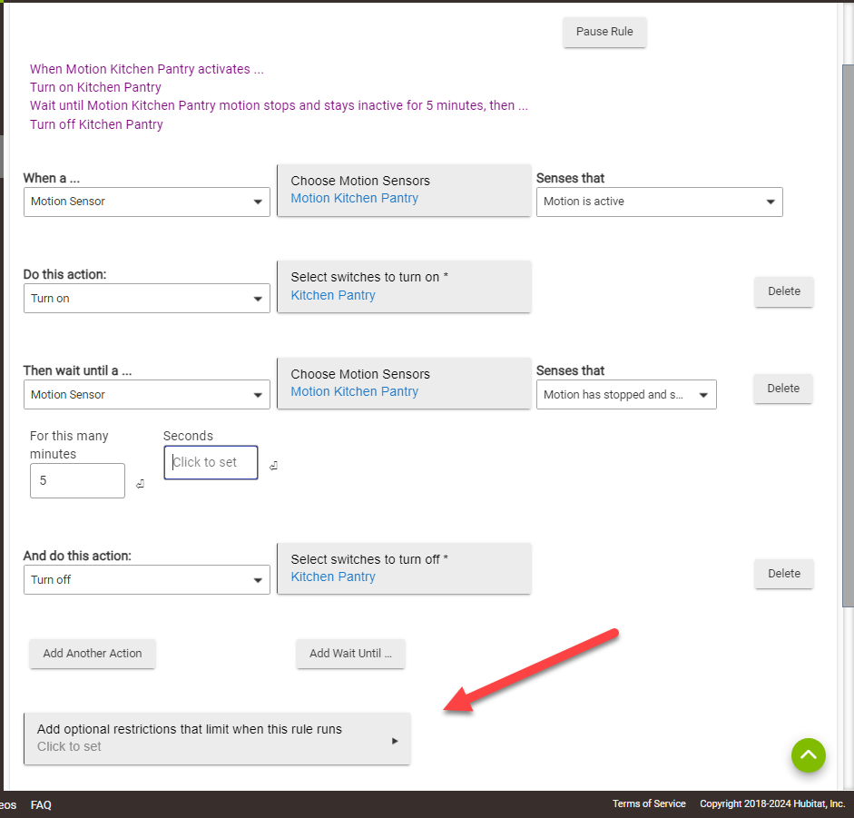

Here's an example of one of the motion sensor rules. Note that there are no restrictions set on it.

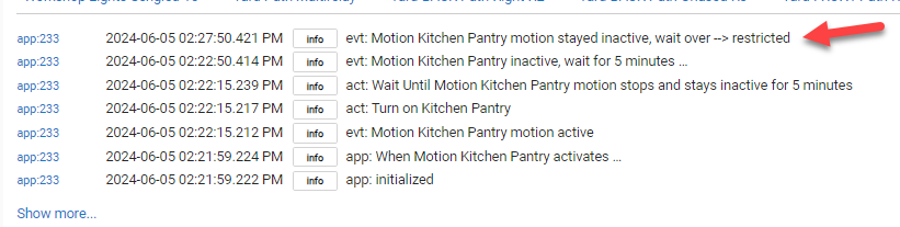

In the app log, it says "evt: Motion Kitchen Pantry motion stayed inactive, wait over --> restricted"

You appear to be running into the Basic Rule bug introduced around 2.3.9.141, which will be fixed in the next hotfix (currently in beta). In the meantime, you can either:
  1. Revert to a platform version prior to 2.3.9.141 or so using the Diagnostic Tool;
  2. See if changing the "Restrict only the trigger..." option in this Basic Rule to that option (as opposed to trigger and pending events) fixes it for you, if applicable; or
  3. Re-create this automation in another app, at least for now, or wait for the next hotfix.
