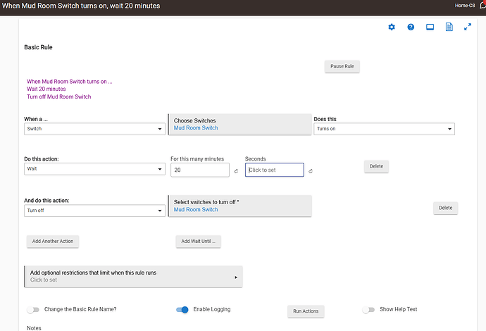

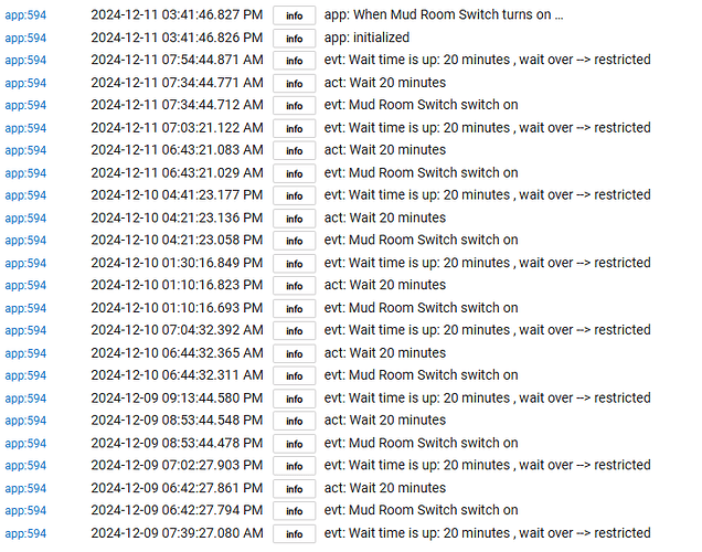

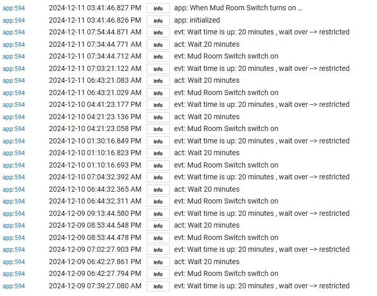

I have multiple Basic rules that the wait until 'off' command is no longer working. These worked well for years but no long work (started sometime in the last year so you can see how high on my priorities it is) I see the timer waits but then where it should be executing the off command it says restricted. There is no restriction in the rule so I'm confused?

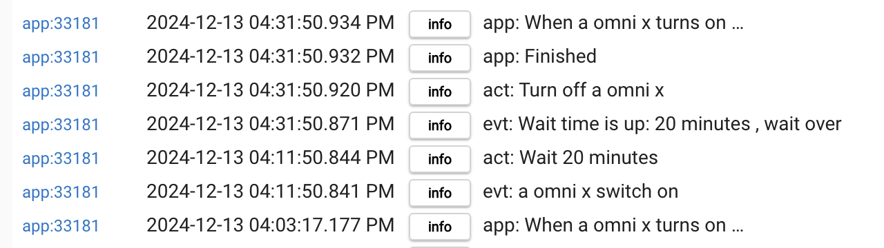

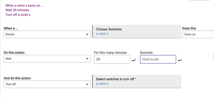

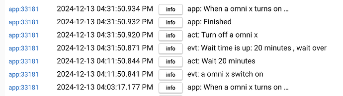

I created a rule just like yours, and it doesn't do what yours does. Strange.
And the logs:

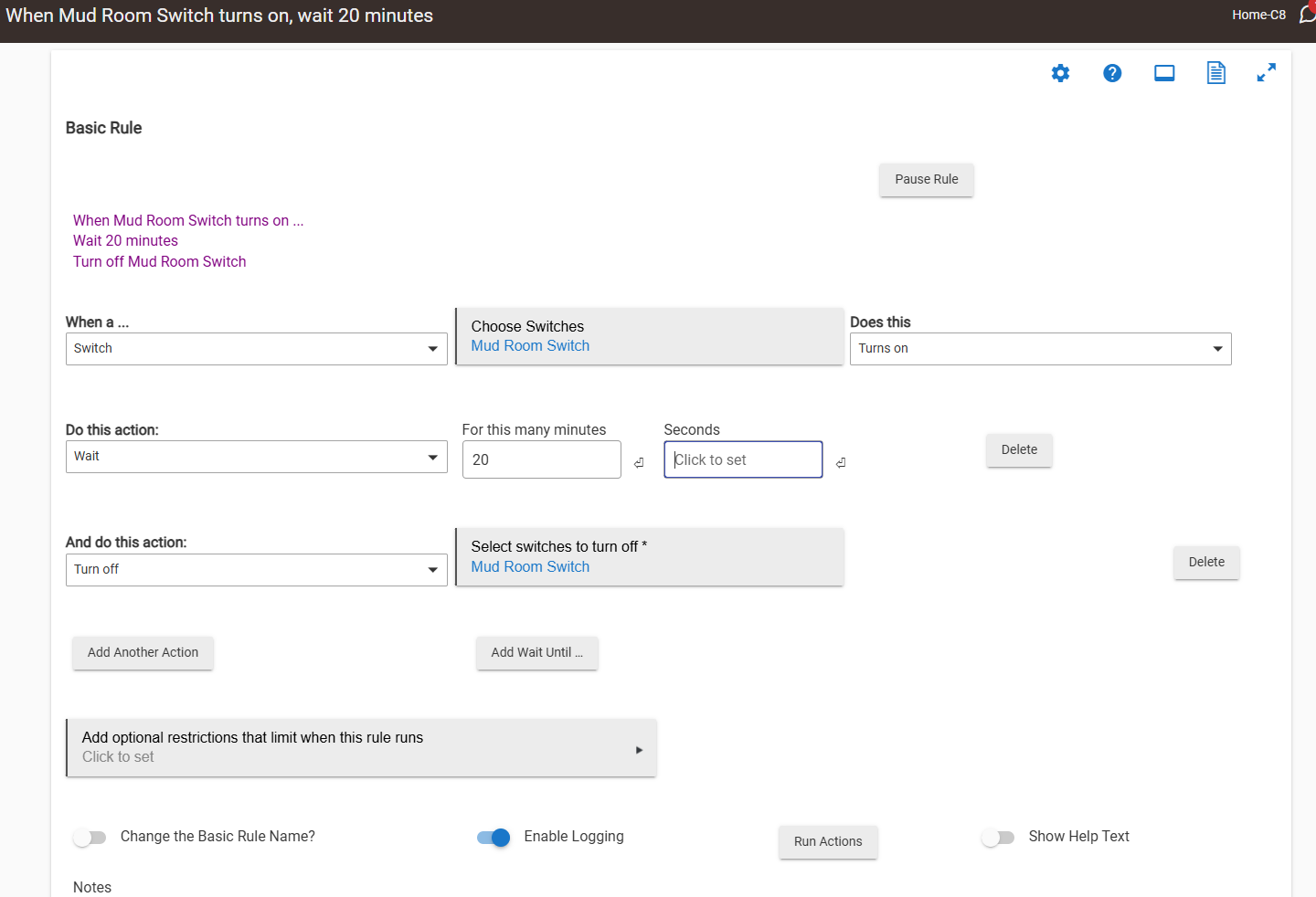

You will have to post the Basic Rule and screenshots of the logs.
@bravenel I have in my initial post
Yes, and creating a rule just like yours doesn't show the problem. That's why I asked @user2242 to show his...
