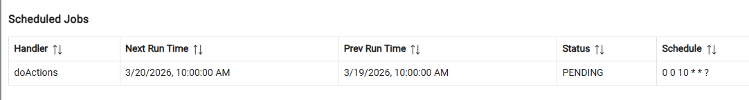

Basic rule set for 3am but running at 10am, hub time is correct
This is a new one for me (well apparently not that new because I can see from the logs it has been doing every day since 3/12 ~ which was prob the last time I rebooted and cleared them):
This basic rule that just states:
When Time of Day is 3:00 AM ... Toggle [a virtual button]
when i check the logs of that device is it being toggled at 10:00 AM like clockwork. - and the rule even shows this in details:
As noted in the title, hub time is correct and all my other basic rules that use time of day are working properly at the expected time.

update: I went to change it and the next scheduled was still saying 10:00 ~ odd. So I changed to "sunset" then back to time of day, then it took as 3:10 AM
