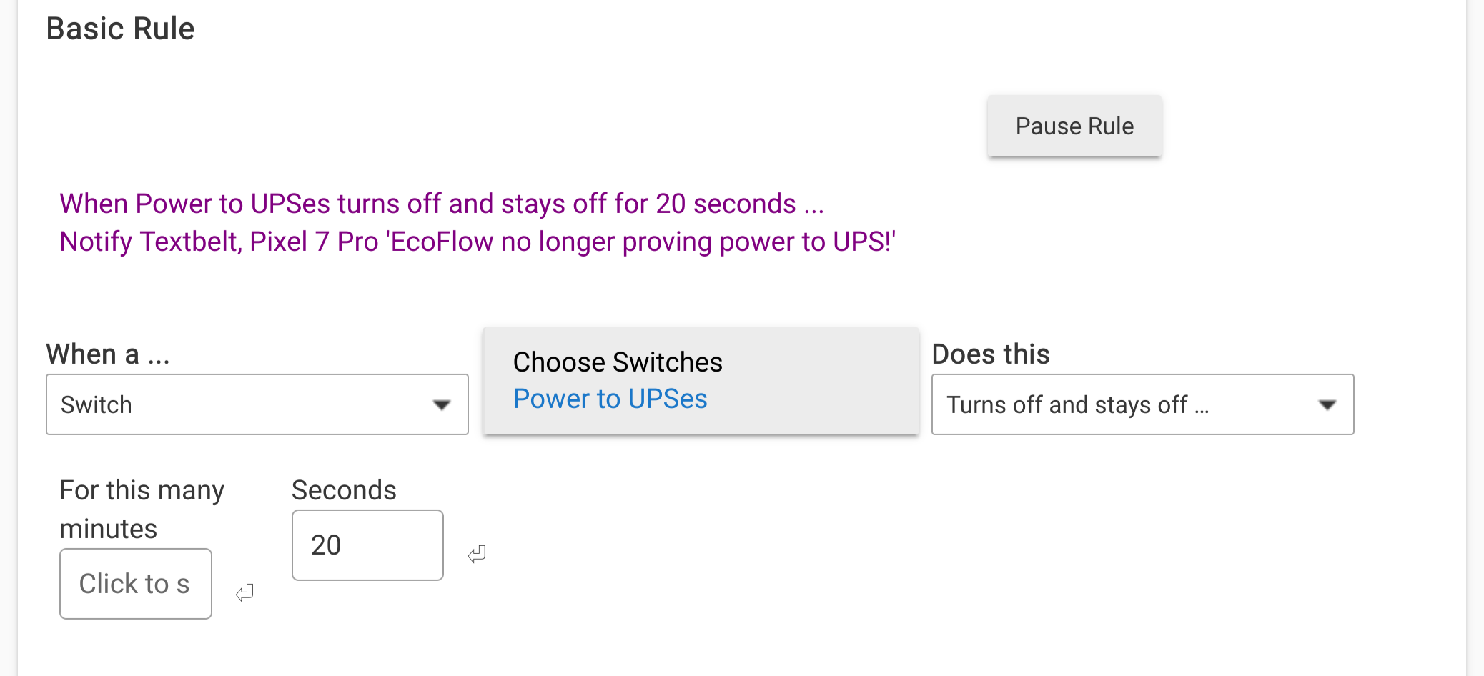

I created a basic rule that monitors a switch and sends an alert if it turns off and stays off for 20 seconds. I'm testing the rule by manually triggering the switch for less than 10 seconds, but rule still fires.
Any ideas what I'm doing wrong or is this a bug?
Here's the rule:

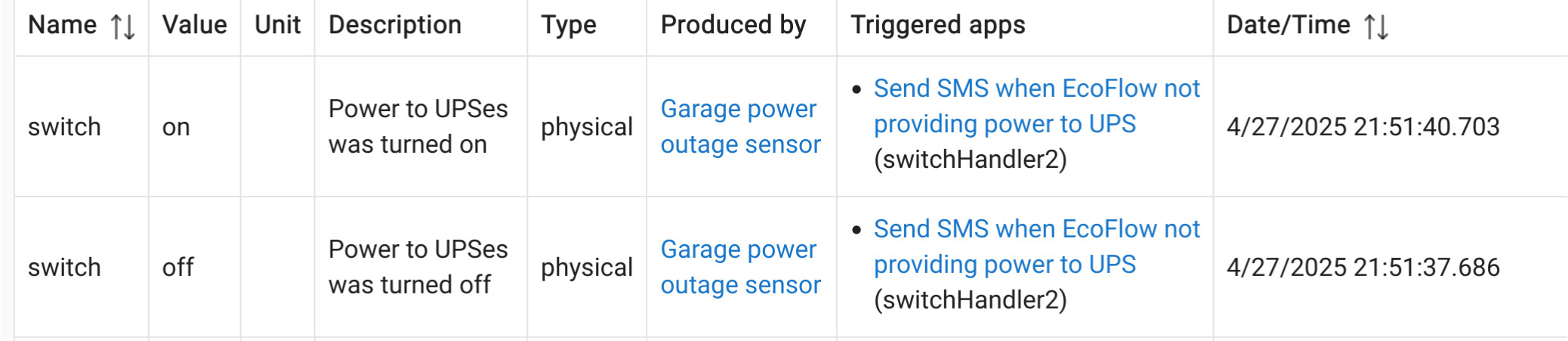

Logs for switch:

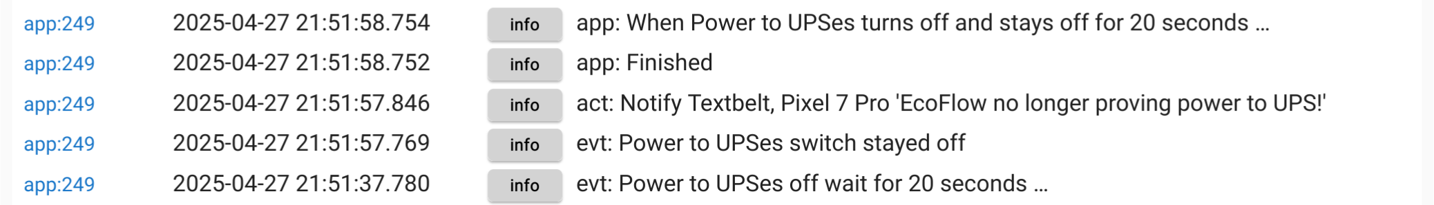

Logs for basic rule:

I will look into this...
Fix for this in upcoming release.
Did the fix go out without a mention in the release notes or did it not get included in this release?
The fix has been released.
