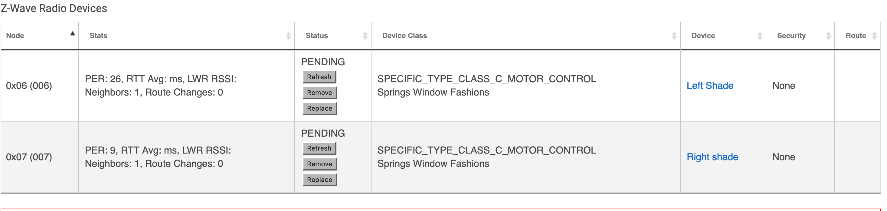

Not sure what I am doing wrong but I am experiencing some pretty persistent troubles with my Bali layered shades and HE. The shades (from all I know) are made by Spring Window Fashion and use Somfy Z-wave hardware. I have reset the blinds by holding the programming button for 7 seconds (both in the fully open and closed position) and then tried to run a Z-Wave inclusion - but nothing worked. I tried inclusion for Generic Z-Wave shades, Generic Z Wave dimmer, Graber shades .... nothing worked. Sometimes I detect a device but it never fully integrates. It always remains on "device with id 07 or 06 detected - initializing" and nothing after that. I am beginning to think either the shades are not compatible with my HE or something else is wrong. I even got Ethernet cables that are pretty long to bring the HE closer but that hasn't helped either. I upgraded the platform software to 2.3 and unplugged everything for half a day and still no luck. I am about to give up if there is nothing else I am forgetting. Not using the remote at all. Thanks, looking forward to some help PLEASE

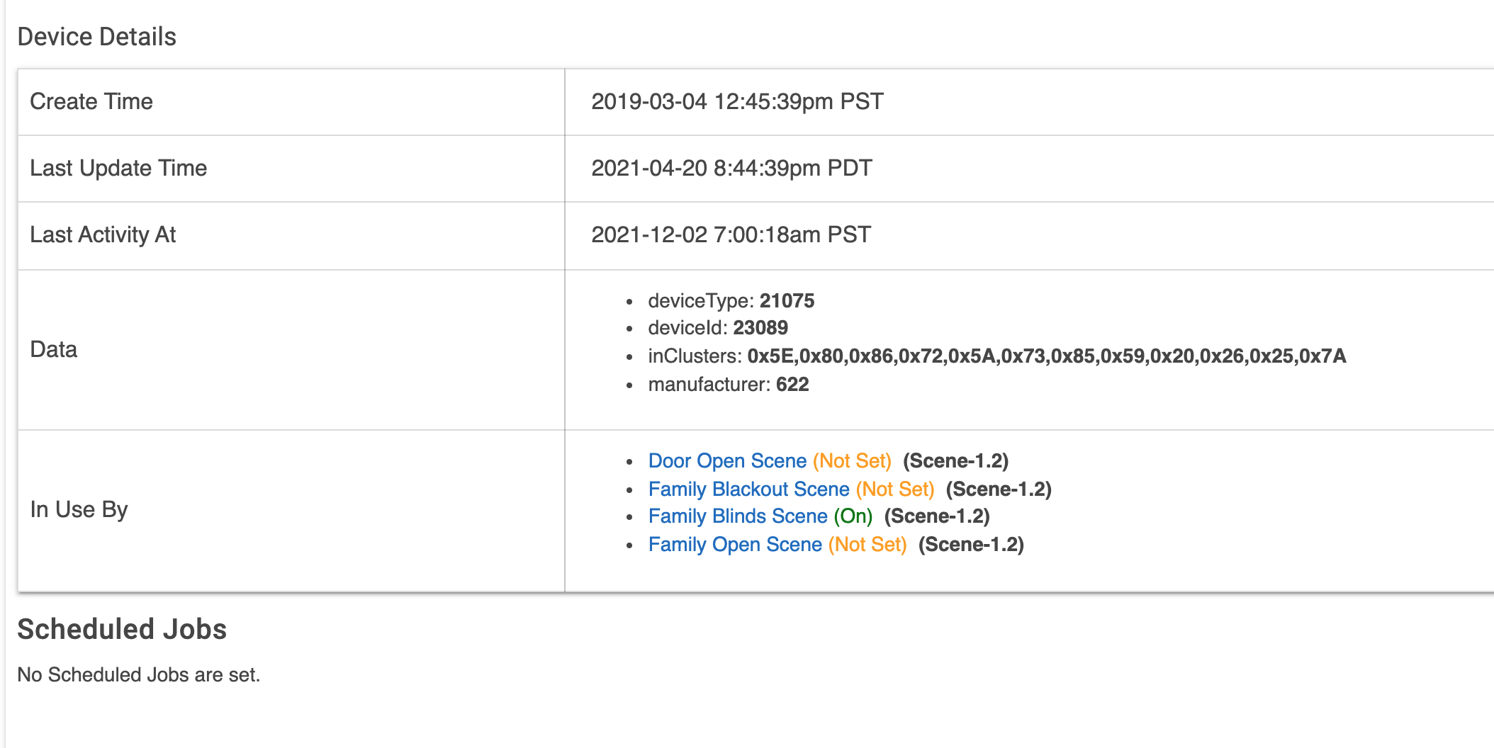

I have Bali (Graber) roller blinds (from Home Depot). And they work well after pairing in close proximity with Hubitat.
In my setup, I have them all configured as Generic Z-Wave Shade, after the pairing process was completed. They all identify themselves like this one:

I ended up figuring it out. I had to add a Z wave repeater and that made all the difference :smiley:
