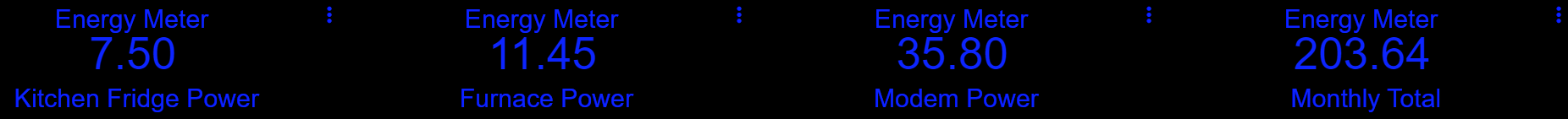

I don't know if that's what you want or not. Whenever there is an energy report, it adds all of the selected energyMeter devices and stuff that value into the created 'omni sensor' device as its energy value.
If you want instead for it to just add the most recent report to the existing sum, then replace the third to last line with this:
def sum = energysum.currentEnergy + evt.value.toInteger()
In other words, do you want a current sum, or an accumulating sum?
Will that sum change whenever a single device adds to it's total automatically, or will a new report need to be ran?
I don't know how these devices work. This app's handler() method will run on each energy report. Is that reported value itself an accumulated value, or is it a new value? If each device is doing its own accumulation then you want the original version. If each device is making a new report and you want to accumulate, then use the replacement line.
I have to run out.... Play with it. It's easy to change how it works -- hopefully obvious with the two examples above.
Each device does their own accumulation, and when more power is added. Say for example my fridge has used 5.30 kwh so far, the next time it cycles the device will report 5.40 now.
