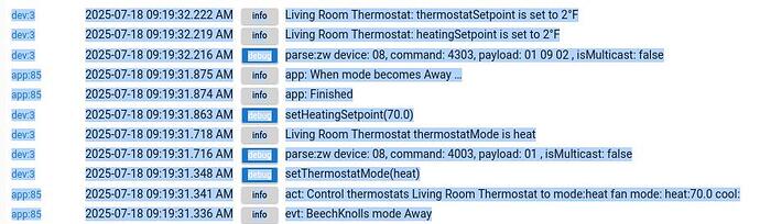

I turned on logging and when the rule is triggered, the app erroneously tries to set heating point to 2 degrees rather than 70 degrees. 2 degrees is not valid and the thermostat just ignores the command from the app and the heating setpoint is unchanged.

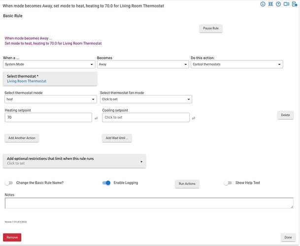

Can you provide a screenshot of the rules / apps involved, e.g. the main RM rule showing how it is constructed. Having some context about other aspects of the automation setup may trigger an idea for someone as to why it my be choosing 2 degress instead of something more realistic.

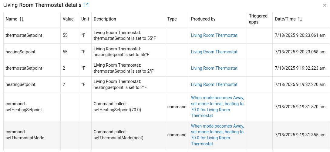

Could you provide the details that @bertabcd1234 requested (it is in the link he provided)? Including the app used, screen shot of the app, screen shot of the logs when the app runs, and a screen shot of the events page from your thermostat device when the app runs.
If you are doing automations using Rule Machine, please turn on logging for Events, Triggers, Actions.

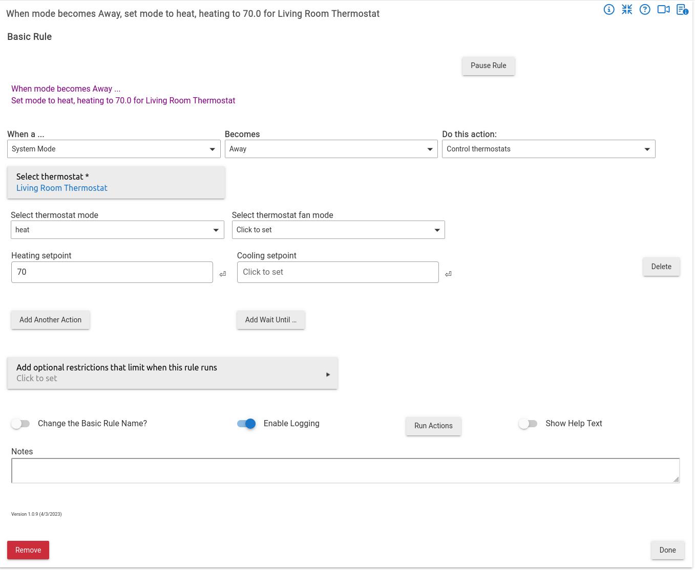

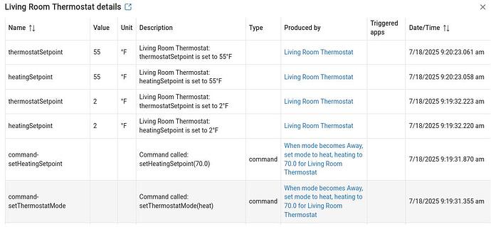

Screenshot of rule:

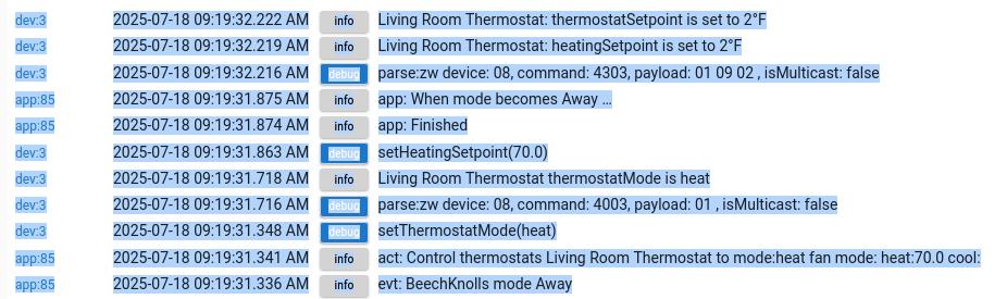

Screenshot of log:
Screenshot of events log:
What driver are you using for this device? (For how to tell, see here -- just stop before you actually change anything: How to Change the Driver Used by a Device | Hubitat Documentation).
Can you provide the same logs for when you manually send a command from the device detail page? If that works, there is no reason the rule shouldn't, either. Keep in mind that this app appears to be sending 70.0, not 70, and I'm wondering if that is related.

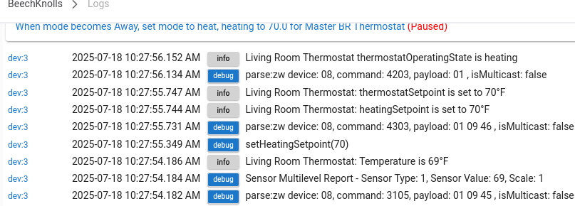

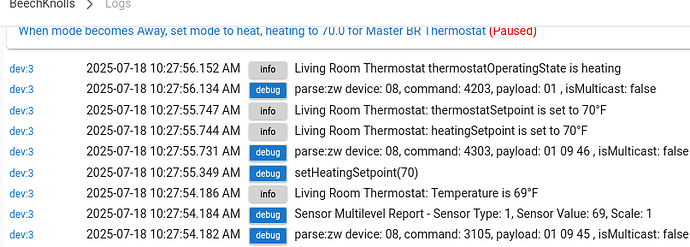

Log when changing from Device window:
What happens if you set the temp to 70.0F via the device page?
Change the driver to Generic ZWave Thermostat. Press the configure button on the device page, and try re-running those actions.
Setting temp to 70.0F from device page works fine.
