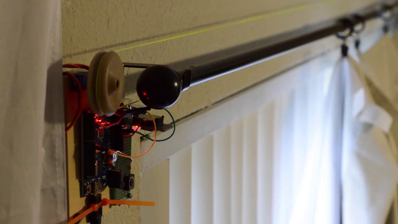

Hi, i have it working with buttons on a bread board. dan is patiently trying to help me get it to work with HE
A link below to a vid on FB let me know if the link works.
Basically i have a functioning prototype that should actually be marketable i just need to sort out the app interface.

That looks amazing. Very clean looking!
remote control via Blynk

This is on my to do list using spectra line (often used on delta printers). But I got to applaud the motors integrated into the end holders - great job! ![]()
How much noise does your setup generate? That's one of the issues for me.

noise wise i wont know until i actually mount it on a wall, as the moment the motor resonates through the test mounts, but they are only printed a 10% infill and mounted on to an unsupported MDF.
once printed solid and mounted on a wall it will be a whole different kettle of fish and if its too noisy ill switch away from a stepper to a standard dc motor.
