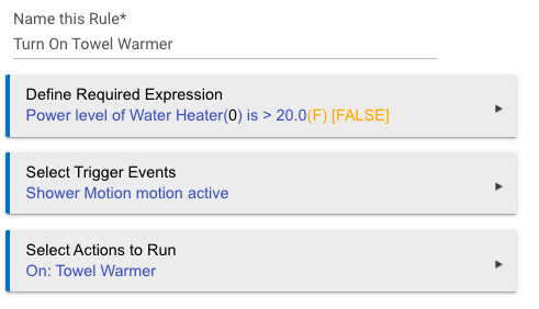

I'm doing something similar with a towel warmer in our bathroom. I'm using a motion sensor in the shower as the trigger and two smart plugs (one for a required expression and the other for the action) to turn on the the towel warmer when the shower is running.
I have a gas on demand water heater that requires electricity for the on/off control. I plugged the water heater into a smart plug and use that as a required expression for my rule.
Screen Shot 2022-03-27 at 11.45.34 AM
