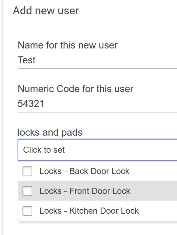

I have 3 locks and I use the same code for all 3. It is easy to add new users and select locks they can use. I use Lock Code Manager a built in app.

Yup I did get the same code on two locks not sure what I was doing wrong the first time. :smile: Still pretty green here myself.
Well, there does seem to be a “gotcha” that is mentioned in the BE469ZP quick start guide (but not the BE469NX user guide) that any added user code (4 digits by default, but can be changed to up to 8 digits) must be different from the first 4 (or 6) digits of the 6 digit master Programming Code. You may have run into this. I’ve had no trouble getting LCM to set same codes on our 2 BE469ZP locks, but I first deleted the 2 default codes as others have mentioned.
I think it was just me not thinking of the Hubitat way. I had entered my name and did the first lock before the other was setup. Then about 2 weeks later I was ready for the other lock and I clicked on my name and add code and tried to enter the same code. What I needed to do was click on my name and then the code and just add the other lock to that code. If I had done them both at the same time I'm sure I wouldn't have had that problem.
