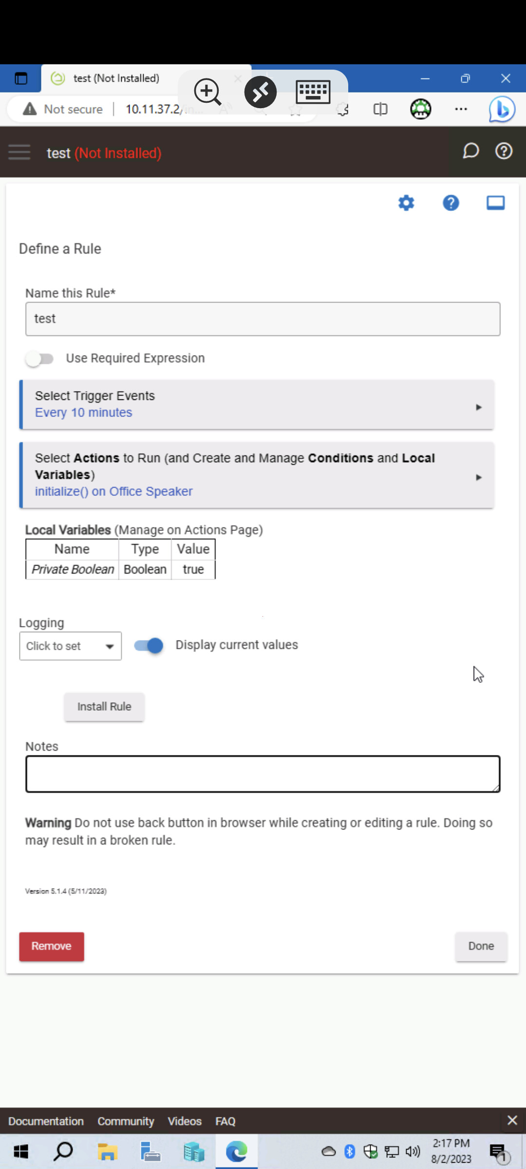

Yes, you can easily do this:
Trigger: periodic schedule
Action: Custom action > speech devices > "your nest mini" > initialize
