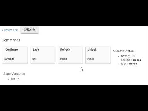

@bcopeland : Do you happen to have a copy of your log at the time you took that video? Curious if there's any glaring differences between yours and mine. I'll attach my log at the bottom for everybody's reference (it's the same one I sent to support@hubitat.com). Prior to recording the log, my August Pro was physically locked and also showing a "locked" state within Hubitat. I then started "recording" the log and did the following:
Executed an unlock command from Hubitat
Saw and heard the door physically unlock
Executed 3 refresh commands (to try and get the status of the August Pro to update)
Never saw the state of the the August Pro change from "locked" to "unlocked" in Hubitat
@bcopeland : Thanks for that information! I re-updated my Hubitat firmware to 2.2.9.134 in order to test this out a bit more. It appears that the log information on my Hubitat matches the log information on your Hubitat for both locking and unlocking the August Pro.
When I press the refresh button, the log information is also correct (as the log entries match-up with your log entries for the expected state of the August Pro). Unfortunately, the "current state" of the August Pro still remains unchanged in all situations. So it appears that everything is acting as expected except for the "current state" of the lock on Hubitat.
Based on my minimal experience developing custom apps and drivers on Hubitat, it seems like this might be an issue with the initial state of the August Pro when updating the Hubitat firmware. If you're not in the lucky initial state at the time of the Hubitat firmware update, you never enter the blocks of code that allow the August Pro's "current state" to actually update. However, if you're in the lucky initial state at the time of the Hubitat firmware update, you will enter the proper blocks of code and everything will work seamlessly going forward. This could explain why one person's lock state is updating and the other person's is not updating, even though the log shows the same information in both people's cases.
