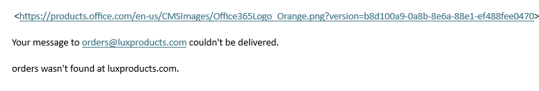

Quote request from Luxproducts kicked back as undeliverable.
