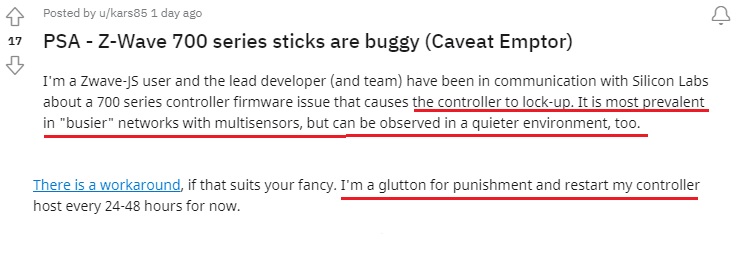

Ran across this thread on reddit that I found very interesting. Even more interesting when you start clicking on the links and reading further. Sounds like a lot of the same issues that no only I have seen at one point or another, but others have reported as well in the forums.
Just file like sharing to see what others think as well.
I highlighted a few interesting tidbits in that thread below. Some of this sounds like early C7 experience. And maybe it is related to what is happening to some here that seem to have issues when others don't. Especially with the Zooz sensors and other problematic devices.

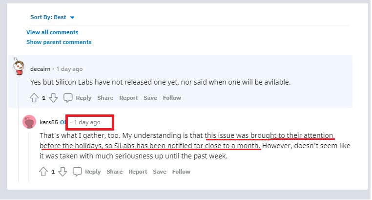

Also funny how Silicon Labs playing dumb "first we ever heard of that...".
Note: the below are edited screenshots, and don't show the whole post.

I hope this leads to a longer term fix from SiLabs. They historically are NOT fast at releasing firmware updates to issues, so this could linger.
I haven't seen confirmation that SiLabs has even reproduced it yet - although I know for sure that a lot of sniffer logs showing the issue and steps to reproduce have been sent to them. There are at least 3 different companies/projects that have reported the issue to SiLabs at this point - and I'm sure others too - I know Aeotec is aware of it, but I haven't seen that they have submitted a ticket.
Side note - the z-way guys say their custom zwave 700 firmware doesn't have this issue, but multiple z-way users have confirmed it does, so take that with a grain of salt too.
We'll all have to wait for SiLabs to reproduce it, and release a new firmware or SDK workaround.

The reddit thread saying the controller "locks up" isn't right either. The problem I've seen is that for reasons unknown the controller stops sending ACK messages back to devices. It isn't locked up, as it can still receive messages, and sometimes send some commands. But the lack of sending ACKs back wreaks havok on the mesh.
Some devices will resend their message a few times then stop when they don't get an ACK (which is good), but some other devices will keep resending the message more or less forever if they don't get an ACK (Zooz XS sensors for one @agnes.zooz ) which is very bad, and compounds the issue drastically. Because of all the traffic, any commands that do make it out of the controller are often delayed - sometimes significantly (tens of seconds, minutes).
As it happens on different software stacks the thought is that it has to be in the controller firmware as that is about the only common factor between the different systems and platforms (as not all use the SiLabs app layers).
