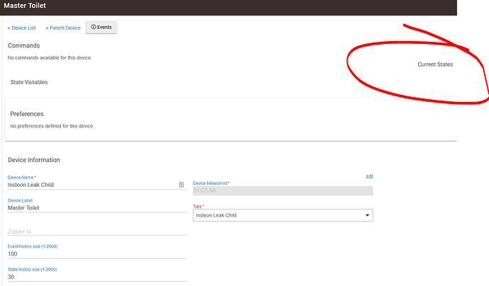

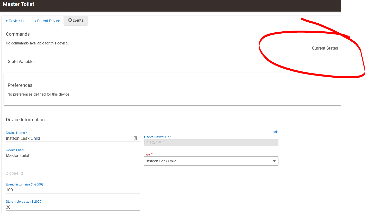

Should the Current State of leak sensors be displayed on each device page?
Yes. Did you trigger it once? It won’t have any state until you trigger it so it can send something for the listener app to forward to the websocket.
Yes
Can you see it detecting wet in the Insteon app?
[Edit] I think I see the issue. Go into your config.json file and take the decimals out of the Insteon ID. It shouldn't have them. Letters and numbers only. After fixing that, restart the server and listener, then delete the child device and recreate it.
If your other stuff is working with decimals in the Insteon Device IDs, that's strange, but they shouldn't be there either.
That fixed it, thank you.
