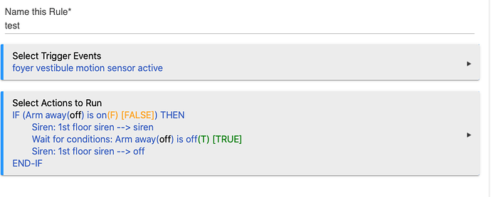

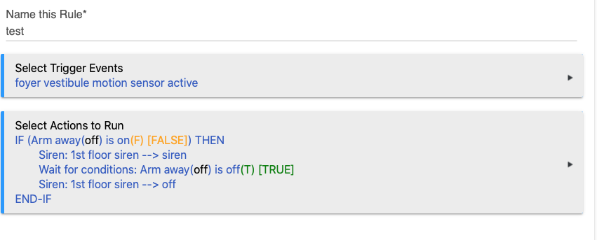

If you want to try to do it with RM instead of HSM you could have the motion sensor be the trigger action in the rule, and then use a conditional before sounding an alarm. Something like this... though my example is probably too primitive to be of practical value (and untested). HSM is really a better way to go.

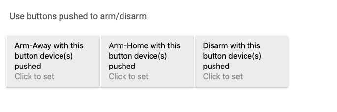

How can I set a button on the dashboard or mobile app to do the arm/disarm option?

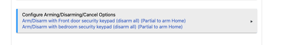

If you go into HSM configuration you'll see options for arming and disarming. In my example I use security keypads either inside the front door or in the bedroom, but you can also just use buttons.
If you click on this option, you will see the following:

You can then use the arm-away and disarm options with either a physical or virtual button, then add that button to a dashboard and away you go.
great that worked....
