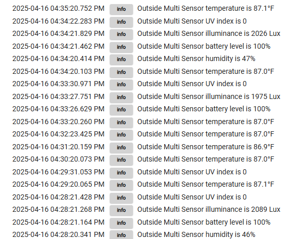

I have been trying to chase down a slowdown that has been existent for several months. For background, I have a C8 pro and am experiencing z-wave slow response time. Zigbee devices seem to be fine. I've traced it to one of two devices:
Aeon 6 Multisensor
Amcrest AD410 Doorbell Camera
On the multisensor, below is a sample of the logs. The question I have is can I reduce the amount of data requests? It seems excessive. I have had the device on my system for 9 months now, however it seems like it has only recently started these excessive requests.
There are many community members using these with no issues but I personally removed my two Multisensor 6's from my mesh. They were nothing but problems and like you are observing spammed the zwave mesh. Any device that routed through it was at 9.6 speed too. The final straw for me was documented here.
My advice would be to remove the power and see if things improve and if so you found the issue. I just don't trust the MS6 and swapped mine out with a NYCE ceiling sensor, which unfortunately doesn't seem to be available any longer.
I had two MS6 on my mesh. After a few years one of them started spamming the mesh (many messages a second, much worse than the OP) and I pulled it off and put it in the box-of-shame. The other seems to still be working fine, even routing at 100kbps. Both of mine are older hardware and were stuck on the 1.06 firmware.

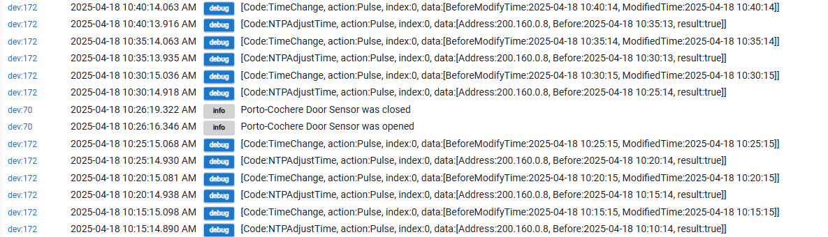

So I have disabled the Multisensor and it seems the system is a little better, however I am also wondering about the Amcrest AD410. Here are some of the log entries for it. Do you see an issue or way to correct this?
I don't know much about that device but I would suggest disabling the debug logging as it creates unnecessary overhead on the hub.
