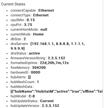

This is my C-8 after running for 22 days.
I do have a rule to reboot the hub if free memory drops below 130M. It has never been triggered. But I agree with @Sebastien that it depends on the exact mix of apps and drivers on your hub.
