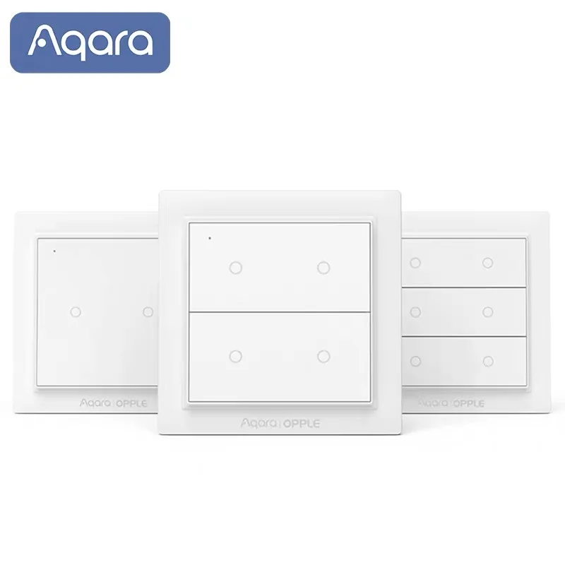

Sorry, can't help with the above options. But I can add one more to your list.
These are quite popular and work well with HE:
