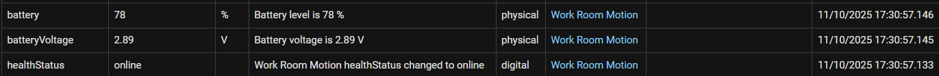

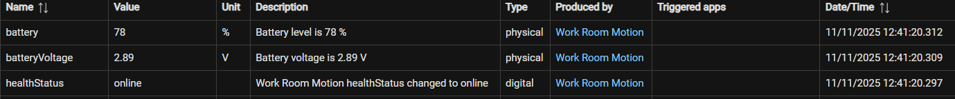

Aqara Zigbee motion all report 78% with new batteries

@dnickel I am almost sure now that there is a bug in the "Aqara P1 Motion Sensor" driver that affects the battery voltage decoding of Aqara RTCGQ11LM (lumi.sensor_motion.aq2) motion sensor. I will change the simple decoding with a more complex TLV algorithm in the next driver update.
This bug is more than two years old, and it's a mystery for me how it has gone unnoticed for so long...

I find my test subject, with the full, tested battery, cycling On and Offline.It seems to happen every time the battery reports in.

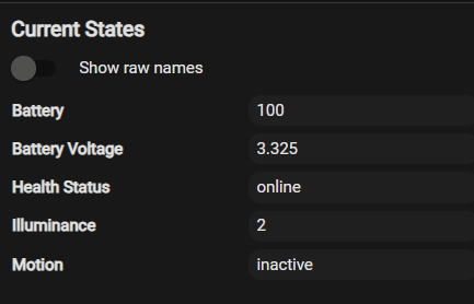

My four RTCGQ11LM are now showing correctly battery voltages 3.075, 3.015, 3.075, 3.035 V

The rest are between 2.97 and 3.325 (test motion) at 100%
