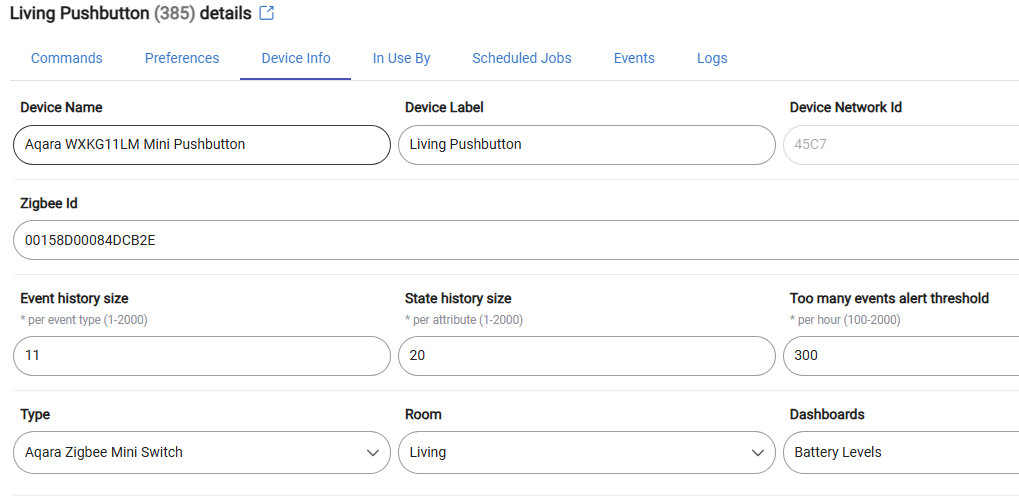

I don't button "run". Here is my configuration with the "Aqara Zigbee Mini switch" driver:
Device info Tab:

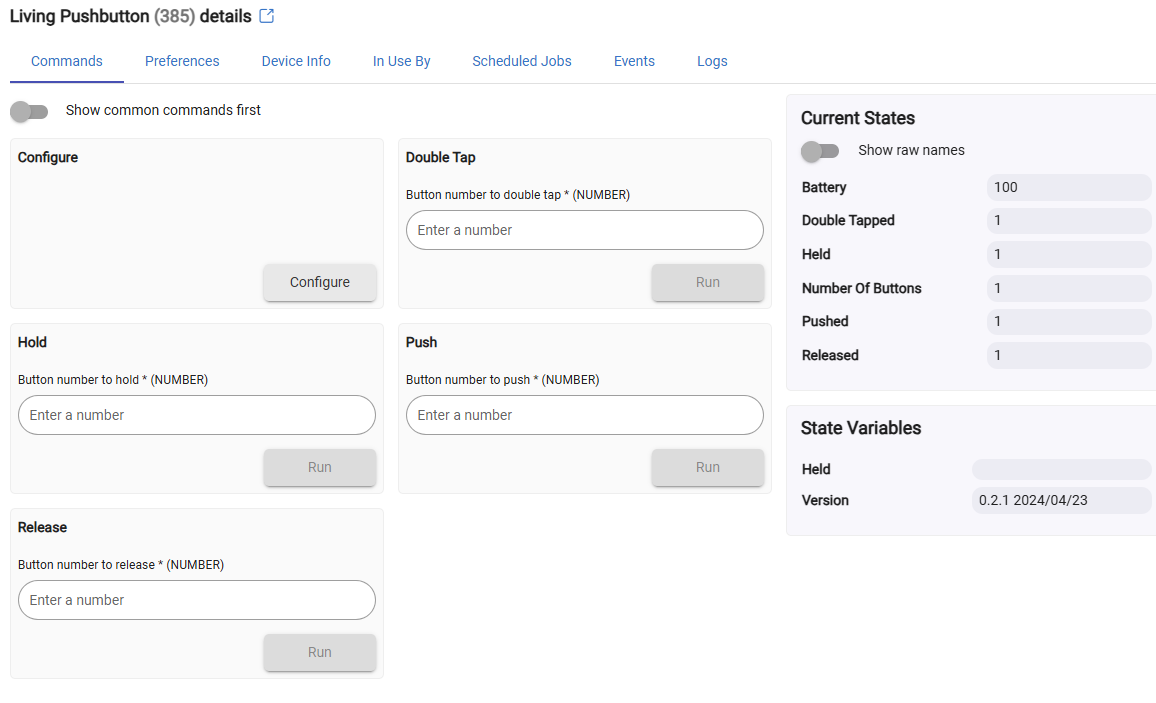

Command Tab:
@mngandersson If you enable Debug logging and press the device button, you should see some log entries in the live logs. If not, it's likely that your device has disconnected from the Zigbee network. In that case, try pairing it again without deleting it first.
