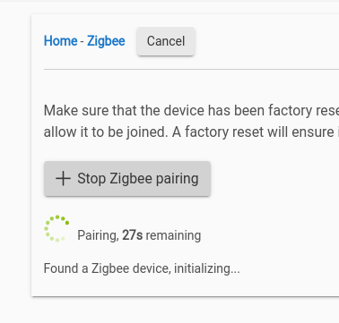

Good to know it's not virtual, I have tried adding Zigbee again and one of the sensors was "found" fairly quickly but the timer completely ran out without completing. I am currently less than a foot away from the hub.
First, reboot the hub and try pairing again.
If it doesn't work, put a fresh battery cell inside the device, if you are still using the one that came with the sensor. Very often these batteries are the cause of the initial Zigbee pairing problems. They don't have the power capacity needed for the extensive communication during the initialization, although if you check them with a voltmeter that may show 3V.
OH, I really liked the new battery thought... I thought it odd the batteries shipped with nothing preventing contact, like ALL MY OTHER SONOFF SENSORS I've received. I happened to remember I had one of these batteries left over and it's now connected, well it found and added the device. Testing will be the next phase, but clearly, I need another battery to try the same process as the other one.

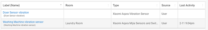

Ok, I confirm replacing both batteries managed to make this work. Now I see they are set to sensitivity low, which means I need to hold in my hand and shake to cause motion. I saw the option to Enable sensitivity level change command 'buttons'., which is now active, but doesn't seem to be able to change to either Medium or High. Has anyone been able to adjust this? or am I even overthinking? I plan on putting on my washing machine and dryer. Is that even needed?
I had these on my washer and dryer. They didn't work well to detect cycle starts and ends. I switched to using power monitoring instead, which works very well. Of course, YMMV.
Totally agree with @aaiyar. The xiaomi's are not particularly sensitive and not useful for knock sensing unless it's quite a hard knock. They do do quite well at tilt sensing (garage doors).
