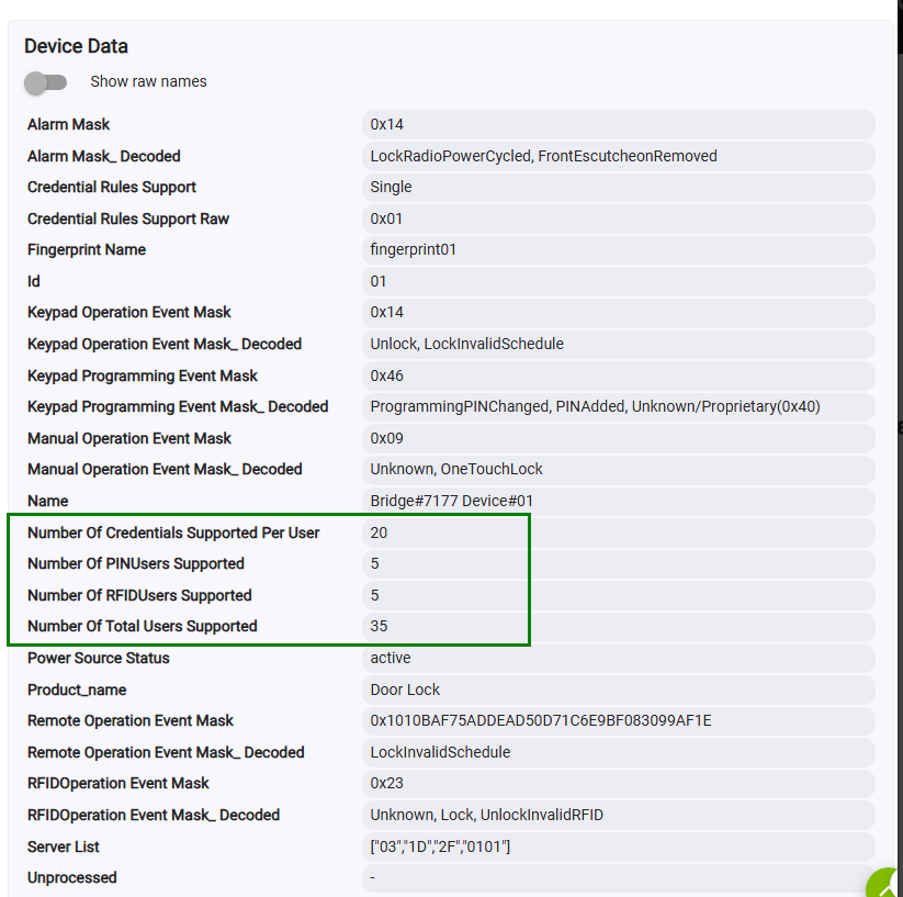

I have been able to add a U400 lock. It was added as a "device" but changing the device type to "generic matter lock" allows me to lock/unlock it. As @bertabcd1234 mentioned, the battery level doesn't function.
You can try the latest version of this community driver; U200/U400 lock codes (including RFID & UWB operations) seem to be registered OK and manageable in RM5.
