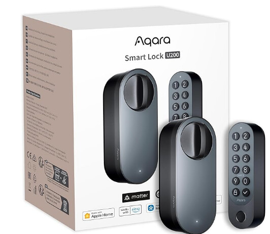

Aqara-Fingerprint-Included-Rechargeable-SmartThings/dp/B0D1C75J4F
Yes. That is the lock I'm trying to integrate with the Hubitat through Matter.
I have it linked to Apple Home and control of the lock works perfectly from that platform.
