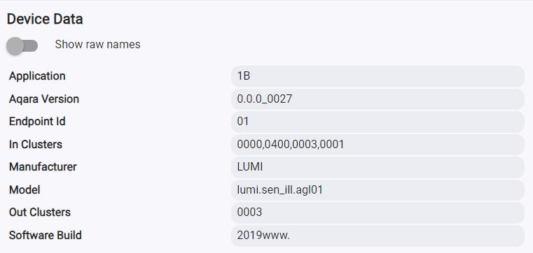

The device page of the new sensor shows “clusters”, which are not present in the working sensor. Has anyone seen this before?

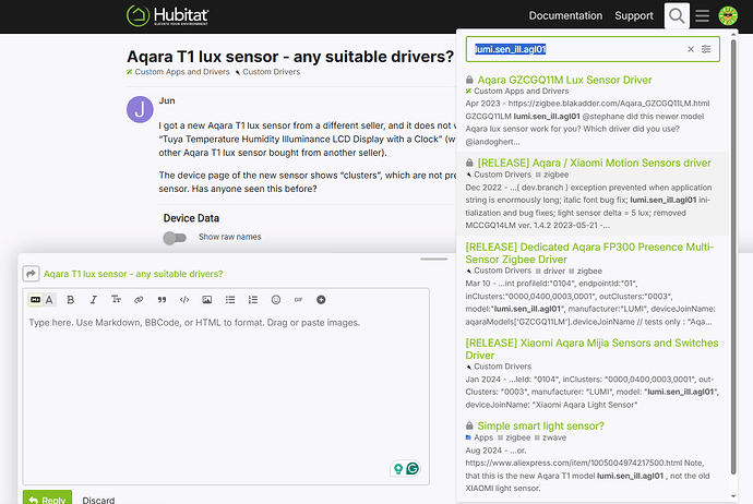

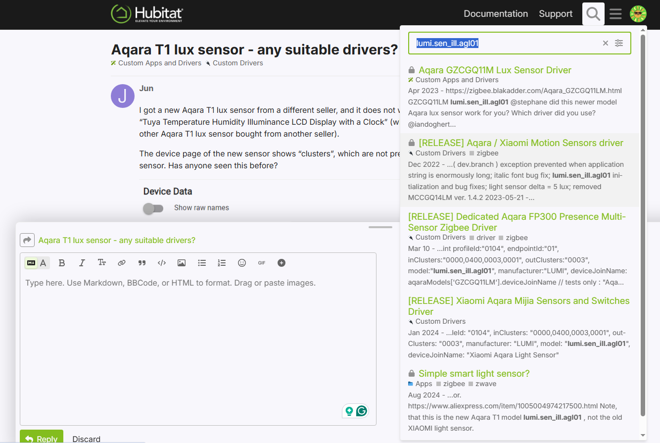

The most effective way for me to find information about a specific Zigbee device is to search the forum for the device Zigbee model or manufacturer. For Tuya devices, the unique identifier is the Zigbee Manufacturer. For all other brands (including Aqara), the unique identifier is the Zigbee Model.
In your case, the model is "lumi.sen_ill.agl01" :

It's unlikely to be a hardware issue... Please check the Hubitat forum Search results for "lumi.sen_ill.agl01". The Tuya driver referred to in the first post is not the correct one.
