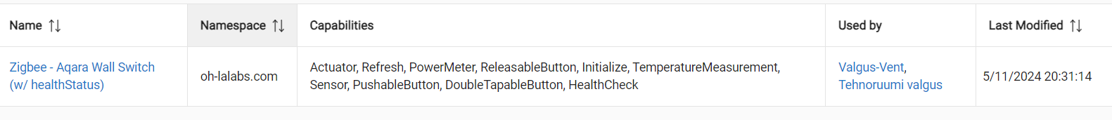

Do you still have the old (the original) version of the Markus's driver?
Go to Drivers Code, type 'Aqara Wall Switch' in the filter field and check whether you have more than one driver which names starts with 'Aqara Wall Switch' :
If you have the old driver, delete it. To be able to delete a driver, it should not be used by any device at this time.
Then, you delete the new switch (use the 'REMOVE DEVICE' red button at the bottom of the device page) and pair it again to the hub.
During the pairing, after the device is found, there will be a 'Device Info' hyperlink. Click on this link before you enter the custom device name/label, as the link will disappear later.
Make a screenshot (or better select/copy/paste as a text) ALL the information that will appear in the popup window.
Under drivers i see only one Aqara Wall Switch:
OK, this means that some of the old fingerprints in this driver is causing HE to mistakenly match the wrong endpointId 2 .... I will try to find and fix it later.
