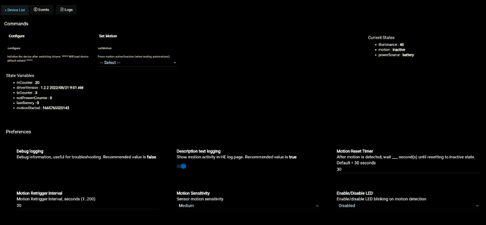

The motion sensor does not seem to trigger from any motion at all. I can change its settings through the hubitat device page, but nothing i change seems to make it start working. I can force it to detect motion through the device page (and it triggers my light automations when doing this), but i'm not sure if that means its actually triggering or if its just hubitat thinking it triggered.

Added some pics

On successful pairing, the Current States should look like this:
