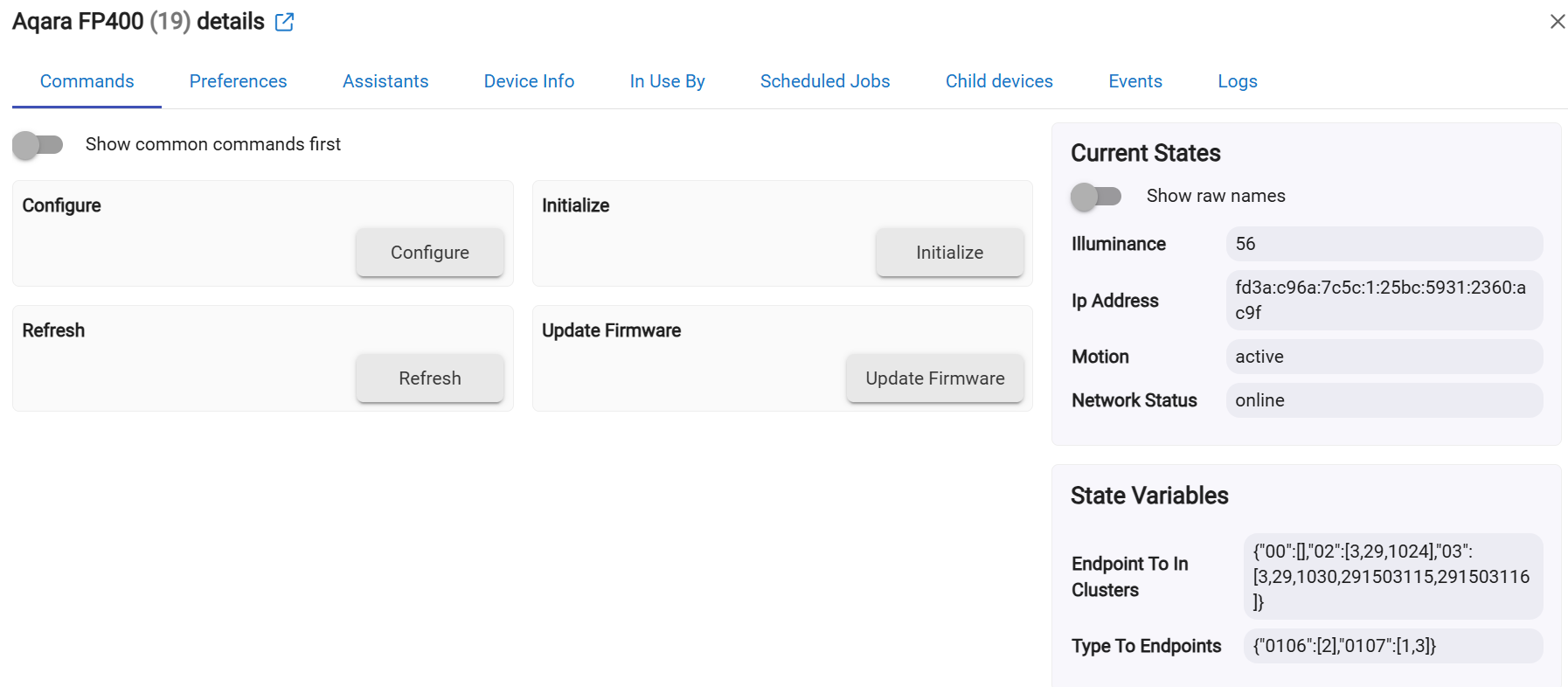

I have an FP400 that I have paired with my Hubitat Hub via Matter. It was commissioned via my Aqara M3 Hub as a Matter over Thread device, and then shared via Matter to my Hubitat C8 Pro hub.

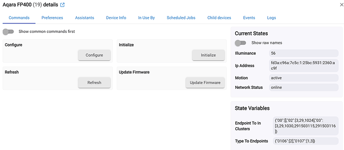

Main FP400 device - shows overall presence and illuminance using the "Generic Matter Motion/Light Sensor" driver which I manually assigned.

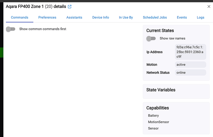

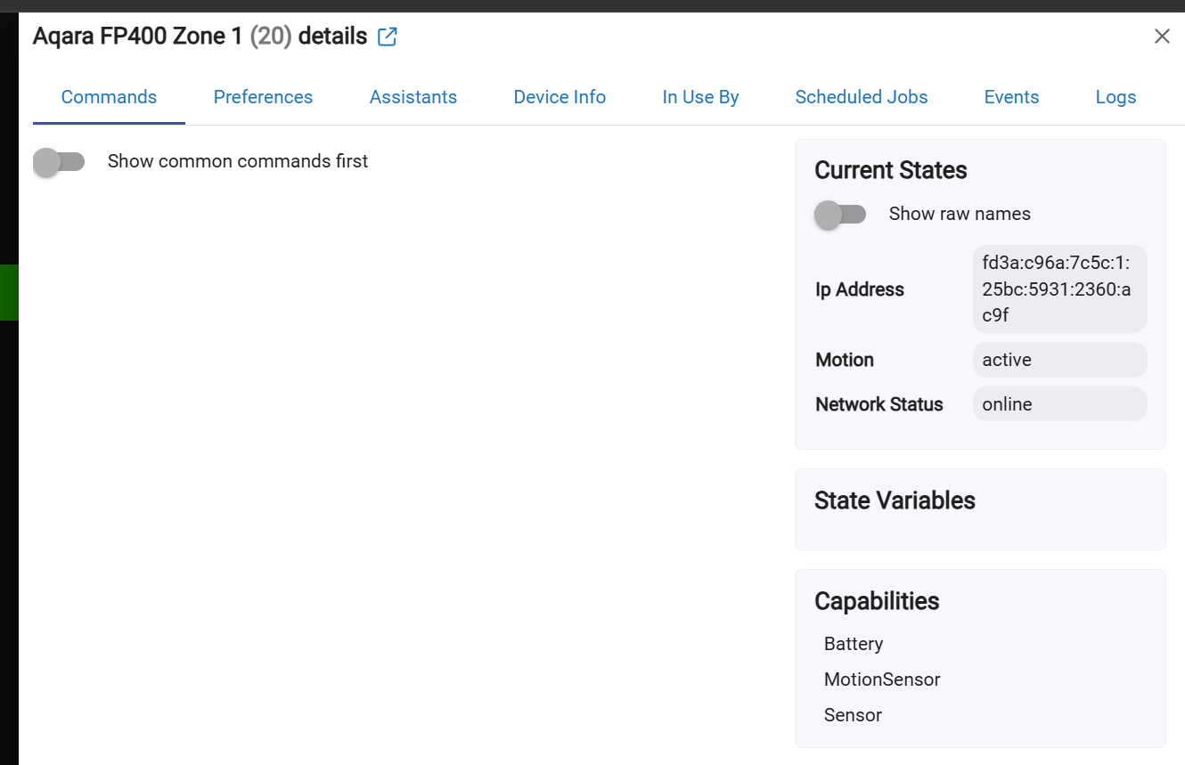

Child device automatically created for Zone 1 that I created using the Aqara mobile phone app.

Most of the "Generic Matter..." drivers should be generic enough to handle any device that matches the capabilities, regardless of which endpoints it exposes certain features on (which seems to be the main way many differ). It does look like there might be "occupancy" on two different endpoints, based on your screenshot, which should also be why the child device was created (also something these drivers do). In my testing with a Meross device that this feature was added for, I wasn't able to get a good description of what endpoint actually meant what (I think I was looking for the descriptor that specified what technology the occupancy feature used: PIR, mmWave, etc., but it was optional and they didn't specify or it used something generic enough that was the same for both -- I don't remember anymore, but my point is that maybe this one could be different and would require some looking into if that would be useful in the first place :slight_smile: ).
I also have one setup via my M3 using matter to connect to hubitat. As @ogiewon stated the motion zones pulled over and are functioning correctly. The only thing I see missing is the lux reporting does not appear as a device like the FP300 does. Also when the "zones" import from M3 they are identified as the generic name "Spatial Multi-Sensor FP400" rather than the name of the zone. If you have multiple zones configured they all come over with the same name. I got around this by deleting them and then adding them one at a time to the M3 then adding them to HE with configure command. Not sure if this can be addressed?

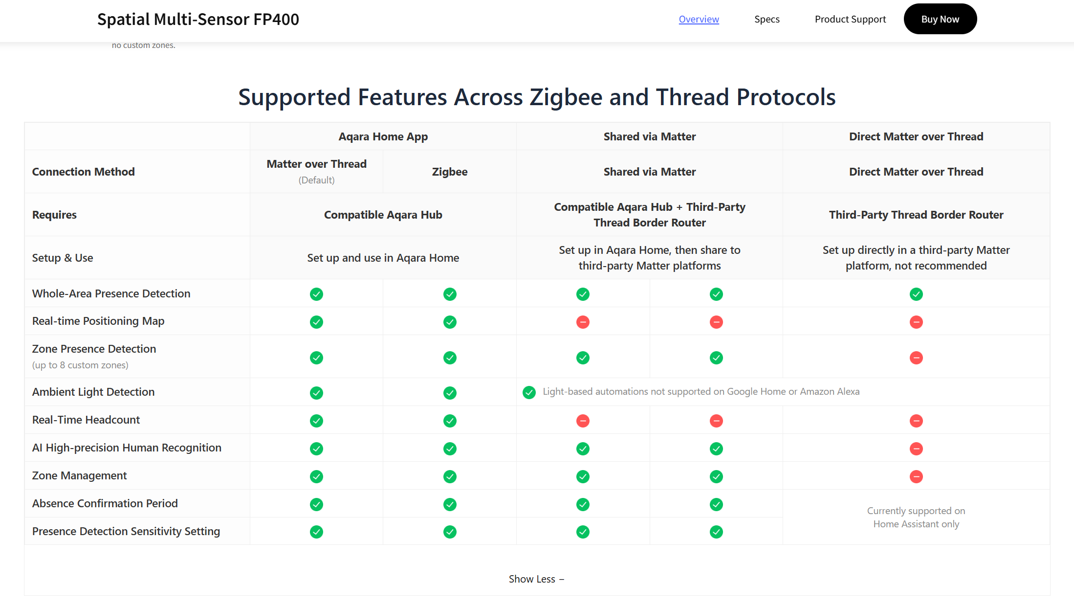

FYI - I just found this comparison chart on the Aqara site. Doesn't appear that there is any major difference between Zigbee and Thread within the Aqara mobile app when the device is paired to an Aqara Hub.
