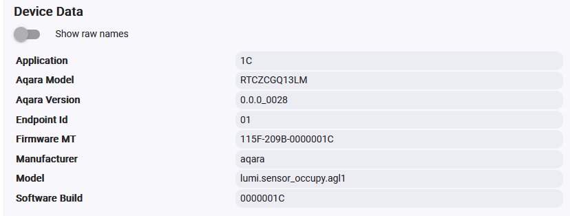

I bought one of these to test and had a few bumps getting in paired but eventually got it working.
  • Previously installed kkossev's ver. 2.1.0 2025-11-23 driver and it paired to that driver.
  • Paired it twice as per the instructions on the driver.
  • Ran spacial learning.
Everything was working for most of the day but after awhile it just stopped reporting occupancy. It's like it got desensitized. I ran spacial learning again and it came back.
This morning after the device was in a unoccupied state over night, it again would not report occupancy. I did another spacial learning which brought it back.

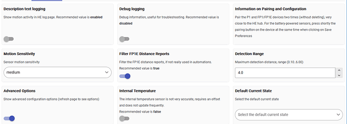

Question, does anyone see something wrong with my configuration?

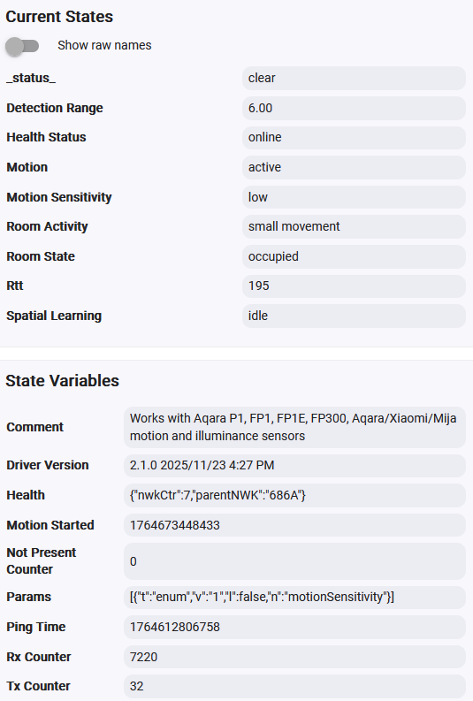

One thing I do notice is discrepancy on the current state showing Motion Sensitivity as low when on the device page I have Motion Sensitivity set to medium. Also Detection Range does not match my setting.

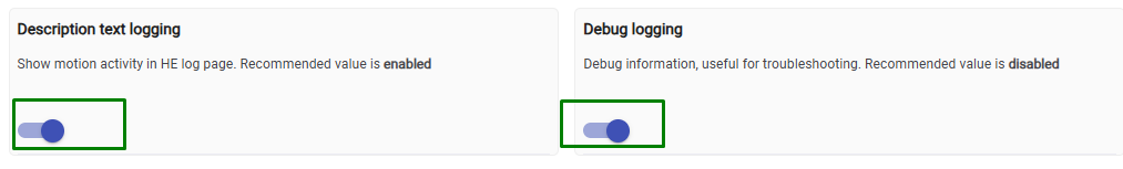

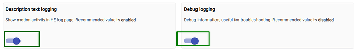

Please enable the 'Debug logging' option in the Preferences section, then click the green 'Save' button. After that, refresh the logs tab and take a screenshot of the most recent logs that follow the "updated()..." text. We should be able to see the device responses there.
expected debug logs

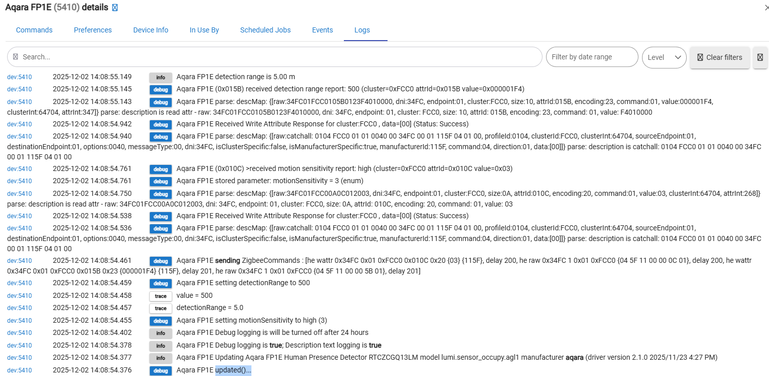

I turned on logging and changed Direction range and Motion Sensitivity and here are the logs from those changes. I don't see any obvious errors.

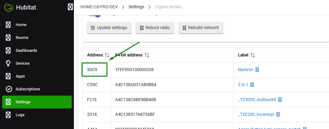

I see in that there is a rather strange one-way-only communication issue - your hub is receiving the Zigbee messages that are sent automatically or periodically from the FP1E device, but the device itself does not react on commands sent from the hub. This may happen if there is a strong WiFi interference at the location where the FP1E is located, or if the mains-powered Zigbee device that was automatically selected as a Zigbee router for FP1 has a bad connection to the HE hub.
The router/repeater used by your FP1E has a short Zigbee address 686A :
You can look up what this mains-powered device is by searching the Settings->Zigbee Details web page for "686A"
I recommend temporarily moving the FP1E device closer to your hub and pairing it again without deleting it. Make sure that the communication is working properly at this close distance. You can use the ping() command to diagnose any Zigbee connectivity issues. Additionally, verify that the settings are accepted correctly and that the motion status changes from active to inactive as expected..
Once you are certain that the FP1E is functioning satisfactorily at a close distance, attempt to troubleshoot the problematic device (NWK 686A), which is likely the most prominent cause of the issue.
Also, when troubleshooting a device, it is better to enable both the Description and Debug logging.

The 686A device is a HMCOZY single board relay. (which may be my issue)
Also, when I first pair it never found the FP1E even when I had factory reset it.
It finally paired but had to use pairing avoiding zigbee 3.0 repeaters.
I tend to agree there is an issue on my end because when the FP1E works it's far superior motion sensors.
UPDATE: After re-pairing again I put the FP1E back in it's original spot and did another Spacial Learning. I then updated my preferences and it appears to have taken.
The FP1A is near to some WiFi such as the HMCOZY which is on an opposite wall to the FP1A. I'll watch it for awhile but progress is being made. Thanks

Turns out my other issue appears to be WiFi interference. Relocated the sensor and it's been rock solid since. Thanks much for your help.
