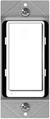

@tzoom , As I understand you're asking for a wallswitch that can handle your heater. Maybe this one will do the job:
Boiler smart switch
It is Tuya compatible so I would think someone will be able to help you with a driver.
