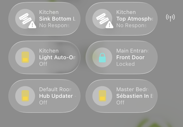

However, it seems like there may be some more testing needed. While the bulbs now report the correct color on HomeKit (excellent), when clicking on the bulb in the Apple Home app, it frequently says "No Response". This makes it difficult to adjust the color within the Apple Home app.
Thank you again to the devs for their hard work. Hopefully, they can completely squash this bug.
I have completed more testing with the latest versions of Hubitat.
The frequent "No Response" error when clicking on a colored bulb to change its color is still happening.

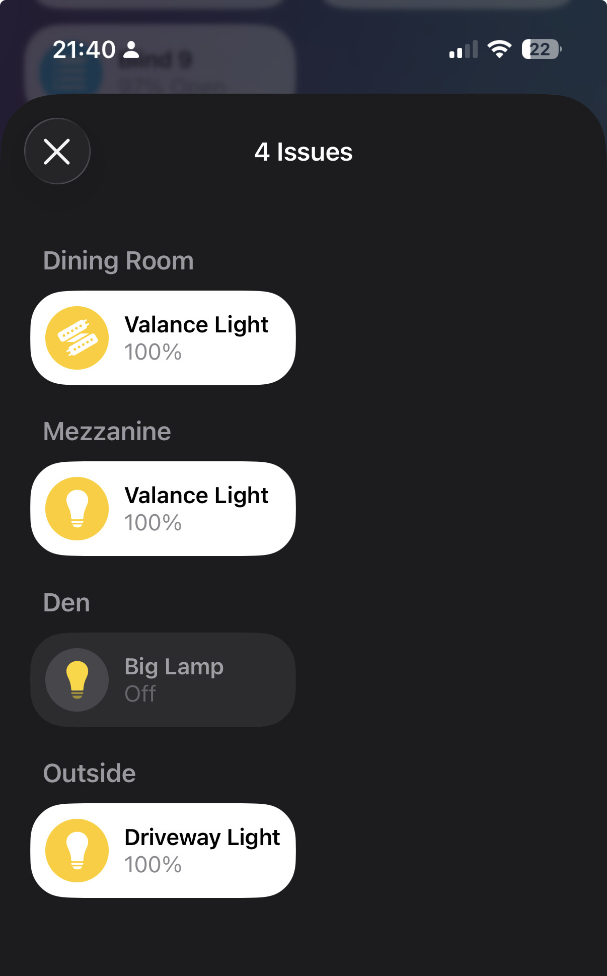

All my RGBW devices are responding and can be controlled, but show as an issue in the Home app. Assume this is related.
Actually can see they say “Not Responding” when you click on them and yet you can still control them. Odd.
Very odd - I’m seeing something similar, except in my case, I can’t control them:
