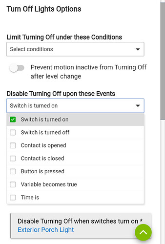

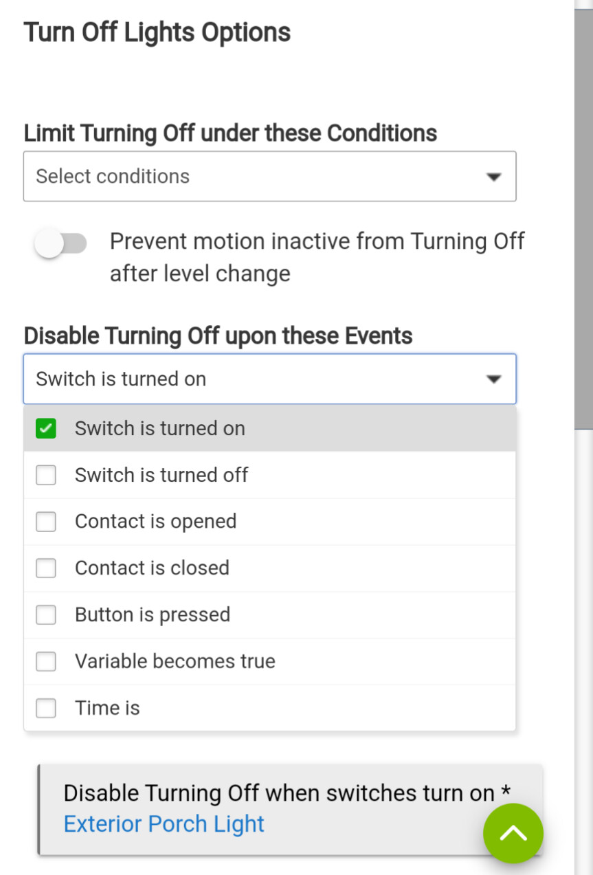

I have used this option in my other room lighting automations that are motion controlled. I thought this option was only available for motion controlled lighting (at least as the toggle in this screenshot suggests).
Is there somewhere else in room lighting that has this option too?
Show your full Room Lighting setup including the Means to Activate and Turn Off. The toggle might still work.

Enabled the toggle and it didn't work:
