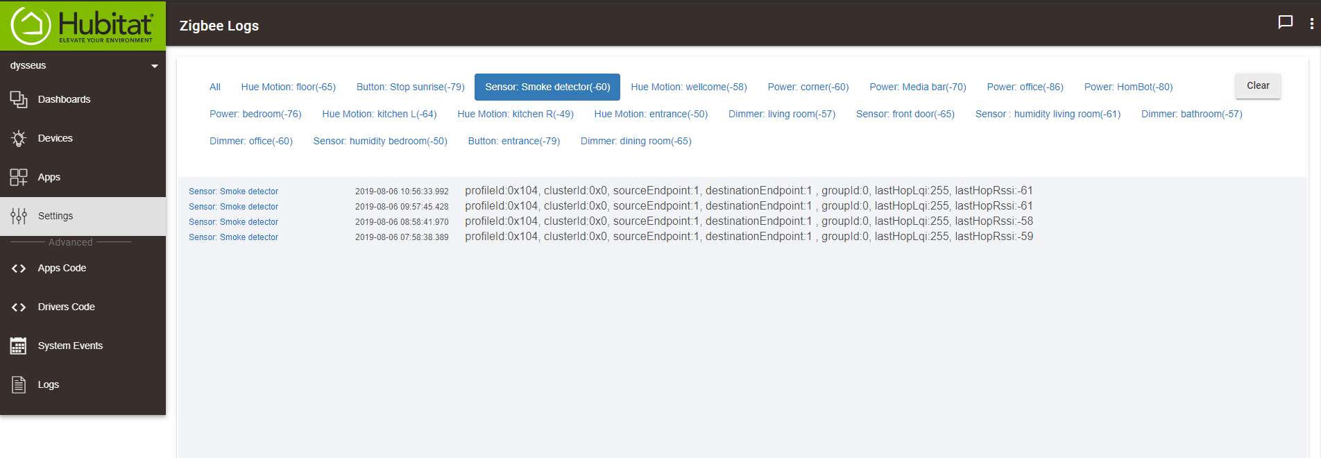

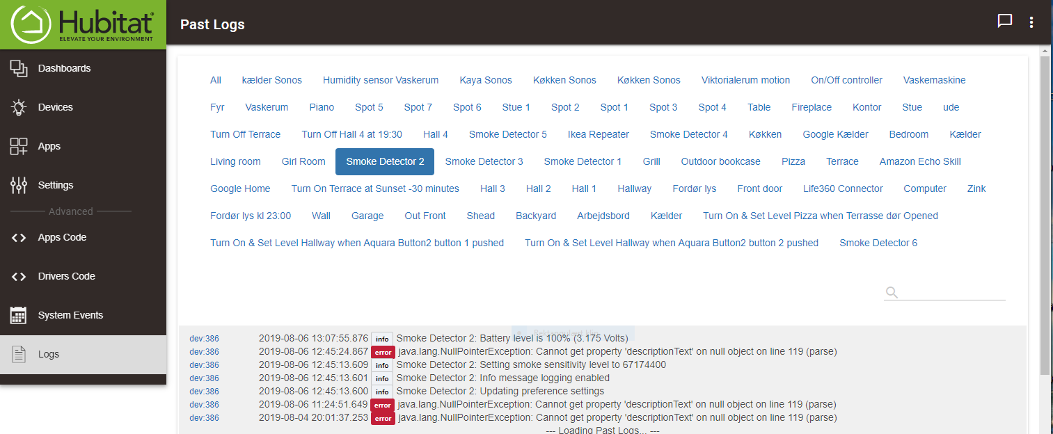

@oliver.lienhard
Under Logs it says:
2019-08-06 12:45:34.530 error java.lang.NullPointerException: Cannot get property 'descriptionText' on null object on line 119 (parse)
Is there something I need to enable??
Also... How do you take screenshots of your browser?? I only know how to make screenshots of the whole screen!
I have everything turned off exept the "Enable info message logging".

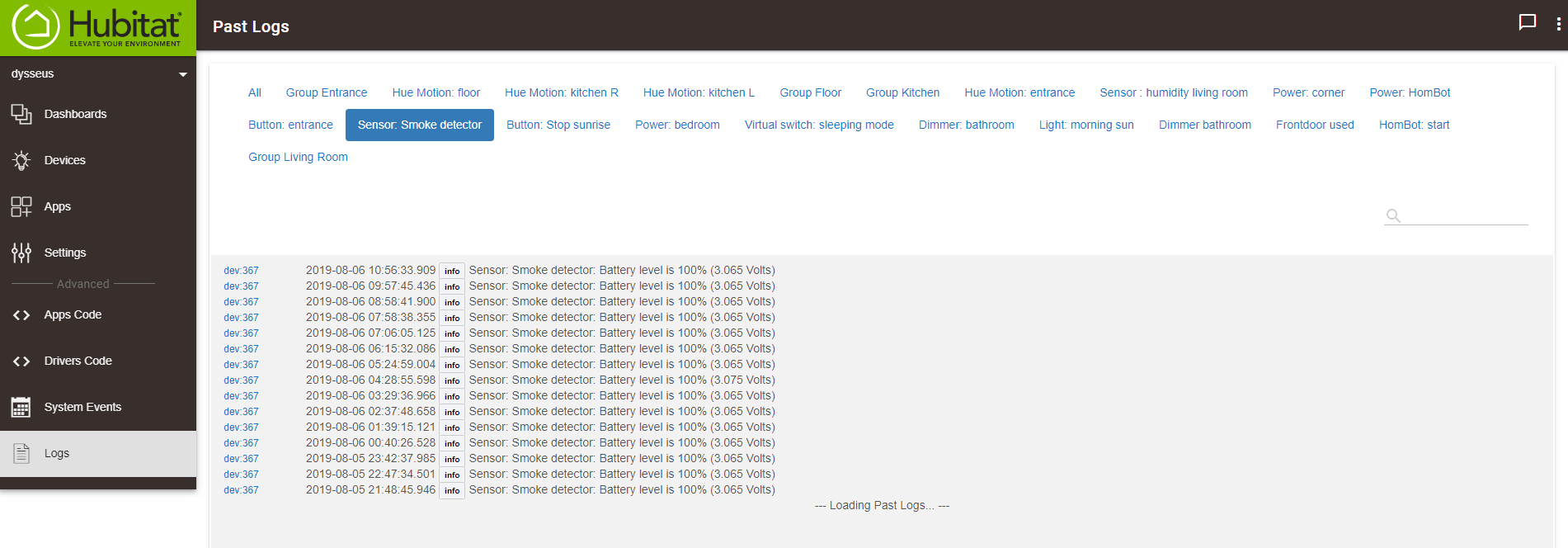

I enabled the info message logging and I think it reports now.. Thanks alot..
Okey, cool... report back if it's reporting fire/smoke
