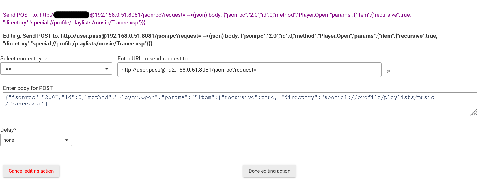

Wow! Thanks for posting this simple HTTP post rule! I've been using a set of Raspberry Pi's all attached to a central NAS for all my video and audio content.. I had to wrestle a little bit with the JSON syntax, so I thought I'd share my experience for other likely RPi users:
Here's what worked for me for my "random TV" scene button:
"jsonrpc": "2.0",
"id": 0,
"method": "Player.Open",
"params": {
"item": {
"directory": "/storage/.kodi/userdata/playlists/video/alltv.xsp"
