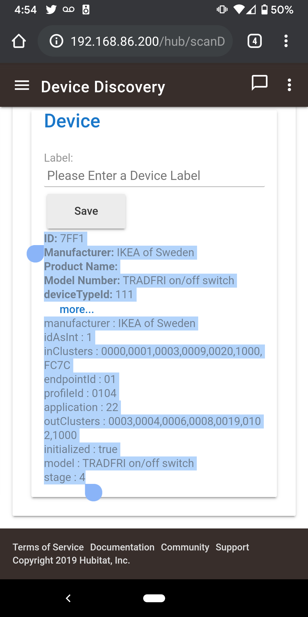

For the On/Off Dimmer Remote
Manufacturer: IKEA of Sweden
Product Name:
Model Number: TRADFRI on/off switch
deviceTypeId: 111
more...
manufacturer : IKEA of Sweden
idAsInt : 1
inClusters : 0000,0001,0003,0009,0020,1000,FC7C
endpointId : 01
profileId : 0104
application : 22
outClusters : 0003,0004,0006,0008,0019,0102,1000
initialized : true
model : TRADFRI on/off switch
stage : 4
