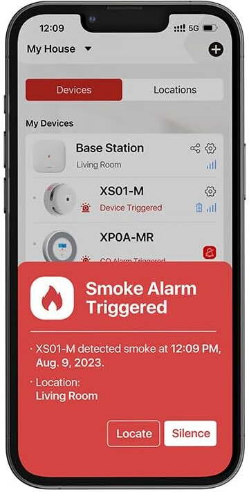

I’m Deaf and looking for a setup that includes a base station that can send alerts to my iPhone. I need about six smoke alarms and two CO2 detectors, and it looks like X-Sense offers a system that fits my needs.
This package comes with 5 smoke detectors and 1 CO2 detector, and it mentions that you can expand the system with additional devices — even water leak detectors, which sounds really useful.
I’m curious if anyone here has experience using X-Sense products, especially integrating them with Hubitat. Also, how reliable and noticeable are the app notifications on the iPhone? Are they obvious enough that a Deaf person like me wouldn’t miss them?

I will check it out and see if any come in a combo kits. I need about 6 smoke detector for each bedrooms and kitchen and two smoke/co2 detector basement furnace room and garage. It'll have to interconnect wirelessly because my house has a finished basement with ceiling sheetrock on.
I use Apple Homekit for everything in Hubitat so do you know if it send alert to Homekit if one of the detector goes off?
So the FF listen for the alarm and triggers Hubitat? If I get a X-Sense and set it up then I use the FF near one of the detector right? I am reading on it but I wanted to make sure I understood correctly.

I went ahead and got the X-Sense kit I mentioned in my first post, and I have to say—it was super easy to set up and link everything together. I'm really impressed with the units so far.
I'm planning to grab a water sensor next, plus one more CO2 and smoke detector for the garage, and a couple more smoke sensors for the other rooms.
Also getting one of those FF modules to link it to Hubitat so I can have it trigger flashing lights in my room.

For future reference, Ecolink FF Audio detector works with X-Sense smoke alarm which I tested. I have not tested on CO yet.
But in default it only listen to Smoke alarm, it need to be set to also detect CO alarm too and to do that you need to press down and hold the tamper switch then next press down and hold zwave switch. Don't press both at time time or press zwave first.
Tamper switch need to be pressed and hold down first before the zwave switch to enable both smoke and co audio detector on Ecolink FF
