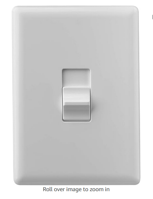

How about a Zooz Zen73 On/Off toggle switch?
Sadly I forgot to mention the other hand tied behind my back - no neutral :frowning: That rules out the Shelly and Zooz options. This is another reason I was looking at the Sonoff previously.

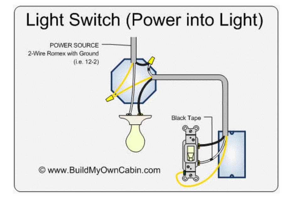

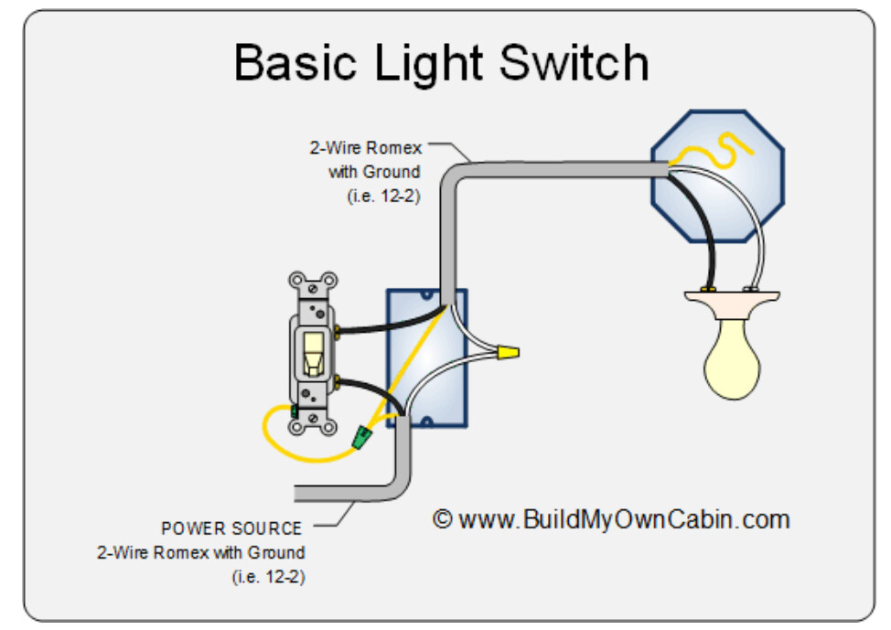

If there is no neutral in the switch box, then the neutral must be at the light fixture. Thus, at the light fixture 'box', you will have Hot+Neutral+Ground coming from the electrical panel. You will also have a pair of wires that goes to the 'wall switch' electrical box. Thus, you should have everything you need to install an embedded relay device to allow your existing switch to work.
This cannot be correct, as you mentioned not having a neutral in the wall box. The neutral must be in either the light fixture box, or the wall box. It must exist somewhere or else your lights will not work. :wink:
Your lighting circuit should be one of the two following designs, assuming there is only one light switch for this lighting circuit.
Neutral in the wall switch box
Neutral in the light fixture box
I see! Super helpful - let me dig into this today. Thanks so much for the detail, this totally makes sense. I believe I am the latter which, if true, would mean I should be able to stick the relay in the ceiling box which definitely has lots more room. Thank you!

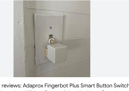

Automate an old school switch? fingerbot works :slight_smile:
It probably does, and there are few other similar devices that manually toggle the physical switch, but all of them are unlikely to reconcile well with OP’s need to prioritize WAF:
I can’t imagine she’ll be that interested in a DIY device that sits on top of the regular light switch.
