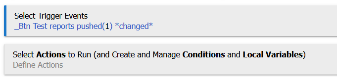

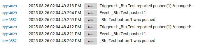

This is not true. It looks for any event marked as a "state change." For many events, that is a new/different value, but button events typically force this (since you need an event even if the old number is the same as the new one). I would not have suggested this otherwise.
It's also easy to test. Here is an example rule and the complete rule and device event logs for two "button 1 pushed" events in a row:
