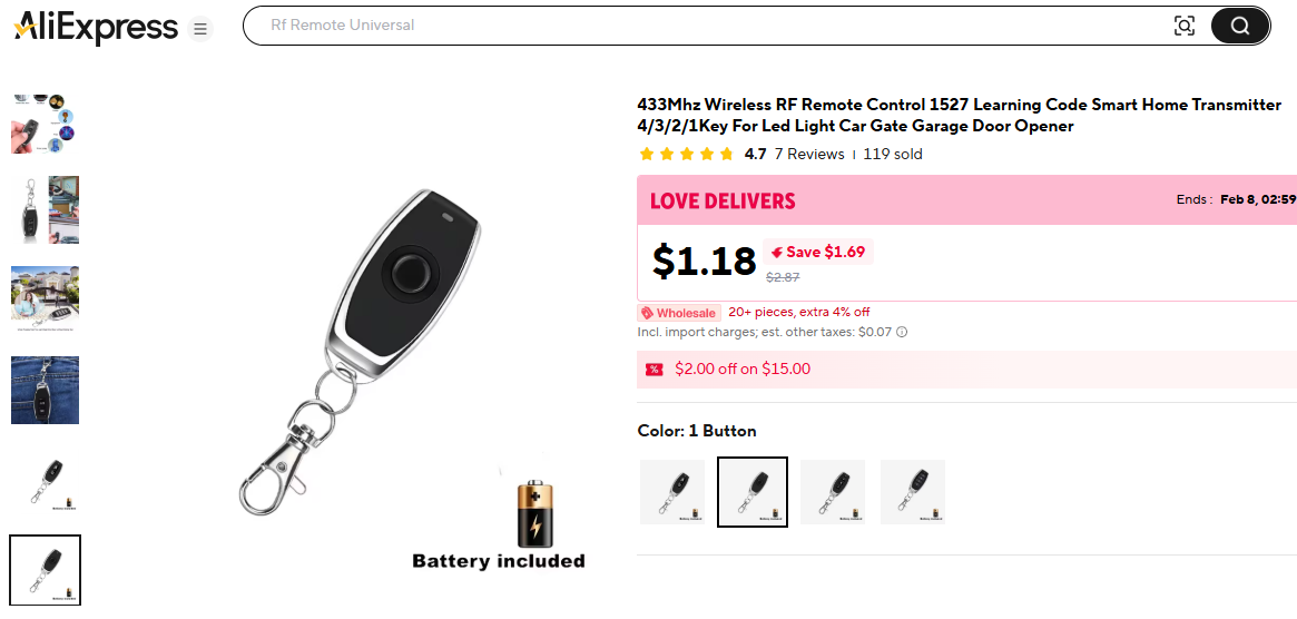

The input power options are what make these really flexible. They all have an RF remote receiver built in as well, some you can buy with the keychain remotes. The remote works even when connected with Zigbee, as another control option. You can buy one without the remote, then buy the remote on Ali Express for like a $1.50.

And Remote (there are instructions with the relay how to pair the remote):
