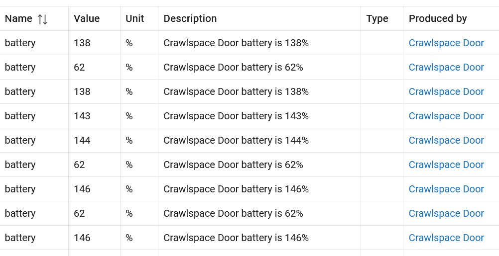

Any NEW thoughts about why battery devices report invalid battery percentage?
Not very helpful reporting...
Maybe the 146 is voltage, 1.46v
And 62% is relative level (1.46/2.4)
As above. Recently when I was messing around with ChatGPT creating a driver for a Sonoff Orb button, one of the things that came up was battery reporting. That device only reported voltage, so the driver does some math to express the battery level as a percentage. To do so it has to assume a maximum and minimum voltage in order to scale 0 to 100%.
I wonder if the battery reporting by the driver is using the curve for alkaline batteries rather than lithium. Lithium batteries have a significantly higher initial voltage than alkaline. That could explain the 140% +/- levels. However, I have no clue why it would drop to 62%. That sounds like a voltage sensor issue.

Can you enable debug logging (and probably delete the scheduled job so it stays on) and see what the debug log that corresponds to each of these events says? That will tell you more about the underlying data that it’s using, which would be the best clue for determining whether it’s a driver issue.

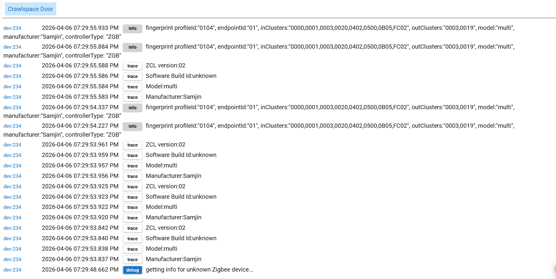

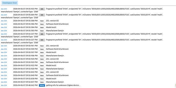

"Get Info" is a command the "Device" driver offers. Open "Logs" since that is where it will log its output, then run the command on the device and copy/paste the "fingerprint" log entry it will generate here. (Make sure the device is paired/not reset, has batteries, etc. before doing this as well.)
But I'd also check that the V5 driver I suggested works in the first place. :slight_smile: The thinking is that if it does (I'd expect it to since it was written for this device when Samsung sold them, and I don't think any actual changes were made beyond branding once Aeotec started to) and it paired as "Device" or something else off the bat (which I'm also not sure of given the information provided so far), the fingerprint could be added to this driver to avoid this trouble in the future. Thanks!
Is this what you are looking for? I am using the Generic Zigbee Contact Sensor (no temp) driver because the temperature was reporting to often.
Yes, thanks!

The logs in question are the "parse" logs that correspond to Zigbee data you'll see right before the "battery" events. I don't see those anywhere above, but they would be the key to figuring out a problem wither driver. The "fingerprint" logs were for driver matching, which is why I was (and still am but it sounds like it may have been fine?) curious about what driver it paired with.
