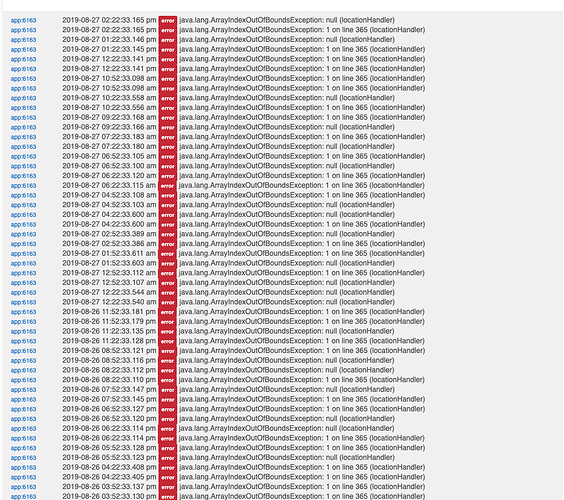

Lately I've been seeing these errors. I only have one custom app (Rheem) and it appears to be working fine. Any ideas how to get rid of it:

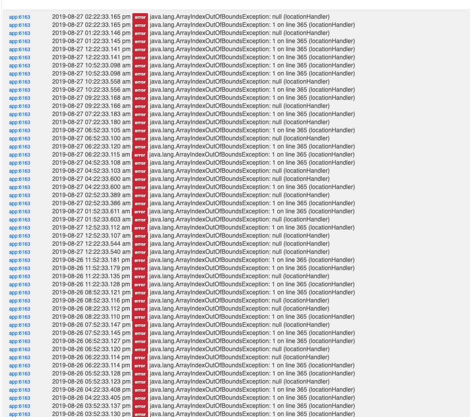

What happens when you click on the red error in the logs? Ordinarily, that should take you to the app.
I never knew that was a link. After clicking on it, it led me to the built in Sonos app:

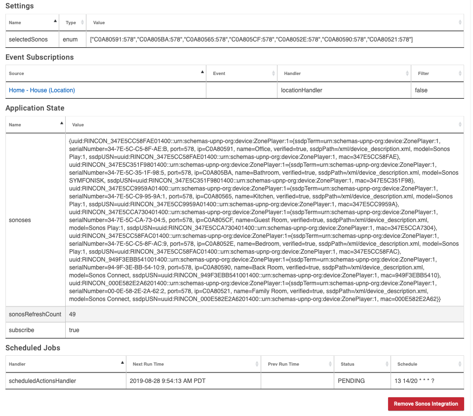

I did remove one of the devices a few days ago and it's not listed in the "Found Devices". @bobbyD sent me an PM to access the following link: http://hubIP/installedapp/status/6163 and here is the output:

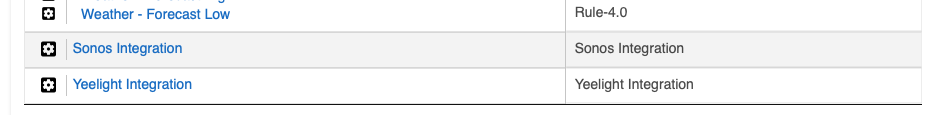

Is the Sonos Integration listed in your apps page?
It is indeed and I currently use the Kitchen and Family Room Sonos for my alerts. As a side note, I've just rewritten all my alerts and announcements to run a separate rule so I can delete the app and install it with a minimal amount of disruption. At this point, I'm just hanging back in case you want to troubleshoot it.

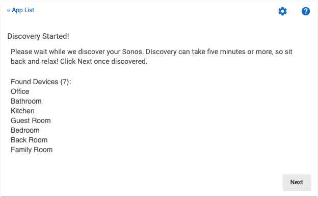

ok, perfect, can you open the app, then click next, then done.

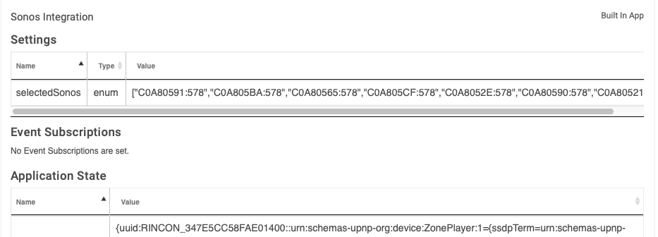

I need to verify that the Event Subscriptions entry "Home - House (Location)" is not there after the app closes.
Done and here you go:
those exception errors should be gone now...
As a matter of fact they are. What caused the log entries and the "null" in the first place?
the location subscription that's used to discover the players never got cancelled and then started to puke from other device advertisements that it didn't know what to do with, in the end it's a slight bug in the integration which i will take a note on to repair...
