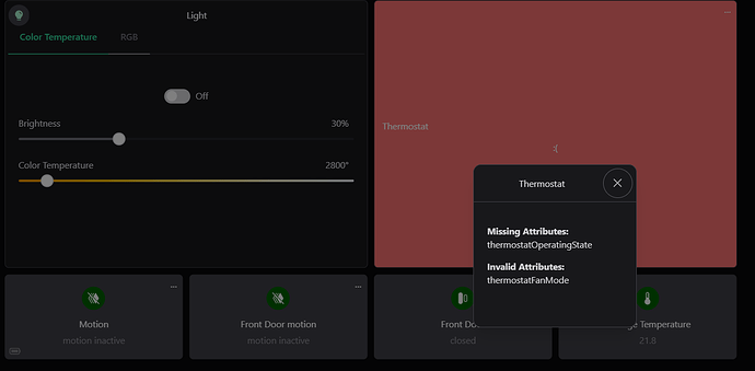

Added a thermostat to the easy dashboard (Matter device) but in the UK we only use heat. So it now gives a error. See below.

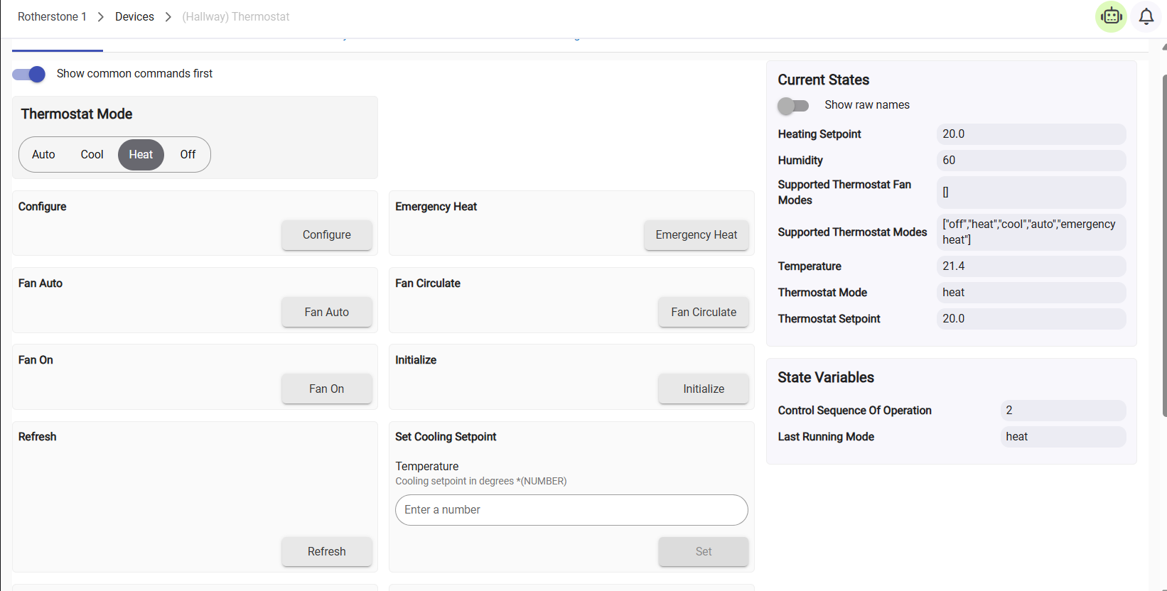

Yeah, I can implement a fallback to backfill fan mode with "auto" if not available.

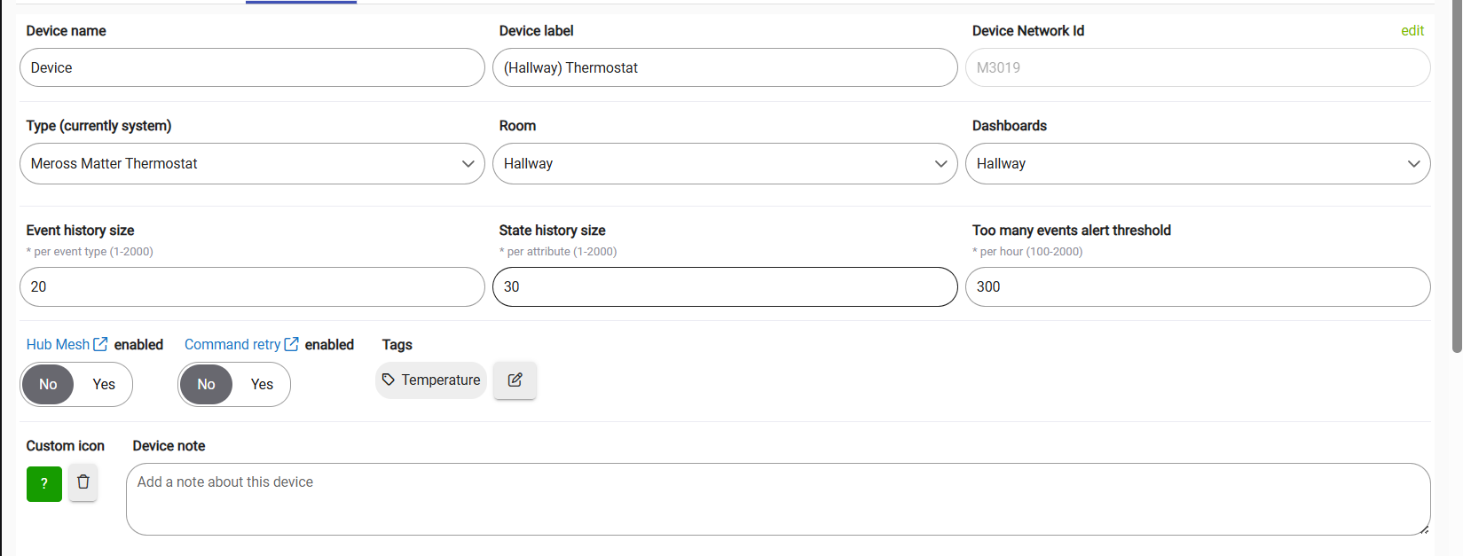

Operating state is a bit more complex since it should always be populated. That's how user would know if the thermostat is heating (burner on) or idle (burner off). Which driver is this?
The inbuilt system โ€˜Meross Matter Thermostatโ€™
:eyes: Haven't found a Matter thermostat that populates this yet..
I'll fake it for the ez dashboard based on the thermostat mode, then. Just keep in mind that if the dashboard says "heating", it doesn't actually mean it :slight_smile:

Now I see that the thermostatOperatingState should be re-evaluated also when the temperature changes.

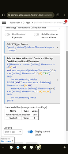

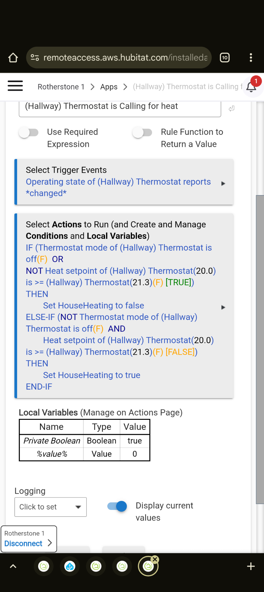

Yeah basically I have created a rule that triggers a HV that does exactly this because it was missing.

if temperature < heatingSetpoint (or >=), you're almost not faking it
EDIT: what @BorrisTheCat did with their rule, I now see.
