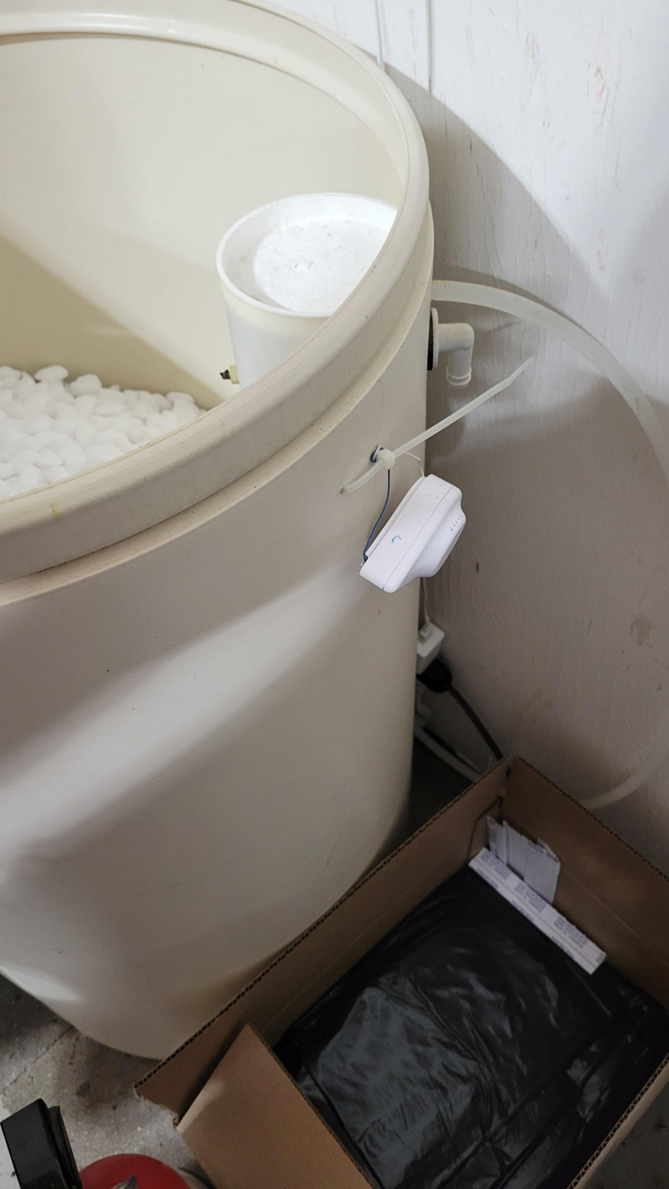

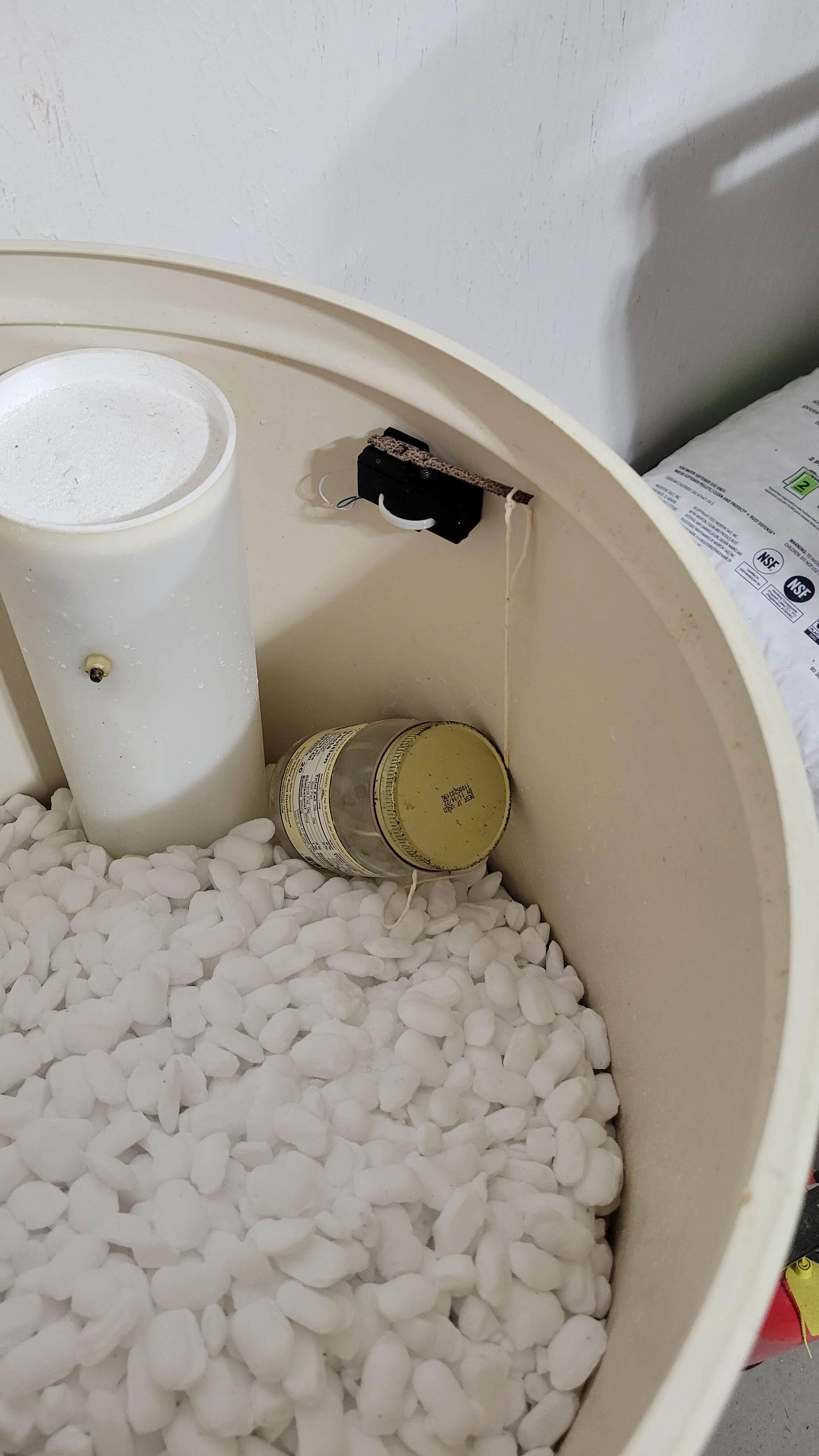

I actually have a scale underneath my water softener but I was looking for the simpler device and here is what I came up with..

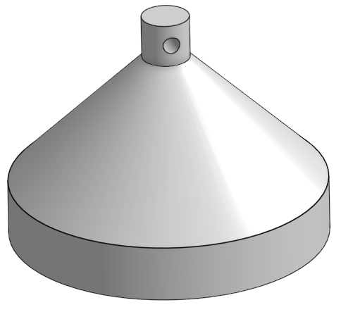

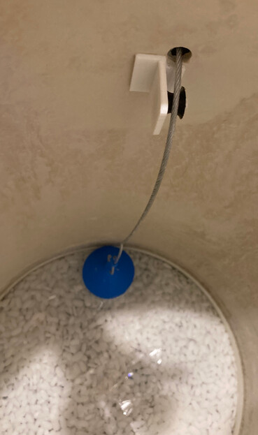

- a weight in the tank that goes down as the salt goes down. 3d printed and then filled with water and plugged.

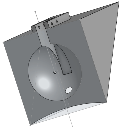

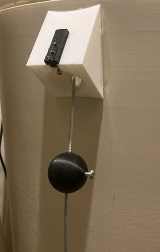

- a ball and a socket with a switch..such that the ball will close the switch when the level gets too low. I did have to add a mini pulley for smooth cable motion
