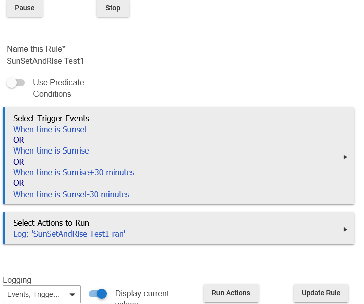

At ~10pm last night I created a concise RM5 rule on .152 like this:
The rule did not run this morning for either Sunrise event. I read that (at least in 2019) you had to wait for the next Sunrise event before the Sunrise+30 would be calculated-- but neither the Sunrise nor the Sunrise+30 was ran.

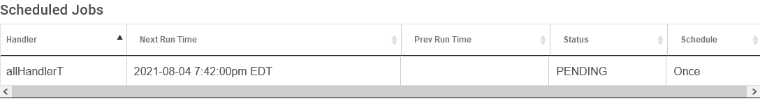

I'm expecting this rule won't run on Sunset either because I just looked at Scheduled Jobs and see this (only Sunset-30):
Should that not have four rows (one for each trigger) - or at least 3 considering that I passed one Sunrise already?

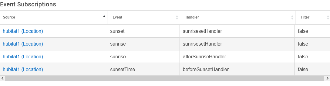

Event subscriptions:
isPrimed = true
