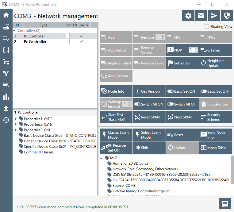

Next, I tried adding the USB stick to the C-5 as a secondary controller, following the write-ups in other forum postings. This worked as expected, however, now many of the command buttons for both the primary (C-5) and the secondary (SiLabs USB stick) PC Controllers are disabled:
So now I can't attempt to add the ZSE40 with no security to the mesh, and get it recognized by the C-5.
Any advice? I searched and read the PC Controller manual, but can't figure out what is causing the disabled network commands.

Yep that’s the order of steps I executed. I undid the first test (standalone controller, with ZSE40 included), then started fresh, including the USB stick using the normal HE device include process. Problem is since the “Add” button is then disabled, I have no apparent way to include the ZSE40 using PC Controller.

What usb stick are you using for the secondary controller? If you can you might try and exclude it from HE by using the general exclusion process in "discover devices" + in PC Controller SW use "Select Learn Mode"/NWE and try again. Use "Classic Learn Mode" for inclusion. Maybe do the shutdown power off thing before attempting another include.

The stick is a SiLabs UZB-7. 700 series Z-Wave chip. I installed the latest Windows drivers from the SiLabs site. After resetting the C-5 Z-Wave radio, power cycle, the inclusion process works fine - detected as a "Device", with a node Id of 2 (no other Z-Wave devices on the C-5).
It appears correctly as a secondary controller, but with disabled commands as noted before. Pretty sure I used the "Classic Learn Mode" for inclusion. I'll re-do the inclusion/exclusion as you note and report back.
Maybe a 700 series controller cannot be secondary to a 500 series controller?
I have a UZB-7 as well and have paired it with a C-5 on occasion.. What version is your PC Control SW?
5.40.106
I am running "5.50.102" - I got it by installing their Simplicity Studio. I noticed that your paired UZB-7 did not identify as an S2 capable controller like my 500 Series Z-Stick. You might consider upgrading. You can install SS and still fallback on the old PC Control SW - I have 5.39 I can run as a backup but am using the most recent version.
I updated to Simplicity Studio 5, PC Controller version matches yours. And the commands that were disabled were now accessible.
