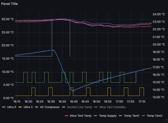

Graphs show the switches going on/off correctly with no buggy actions. However, last night at 4am the rule just stopped running. This caused one of foggers to be left on few few hours...things got a bit wet. I can only assume this error had something to do with it....but if your implying its a damage free error im thinking there might be something else at play. I did triple check that all devices here are only controlled by this rule.
