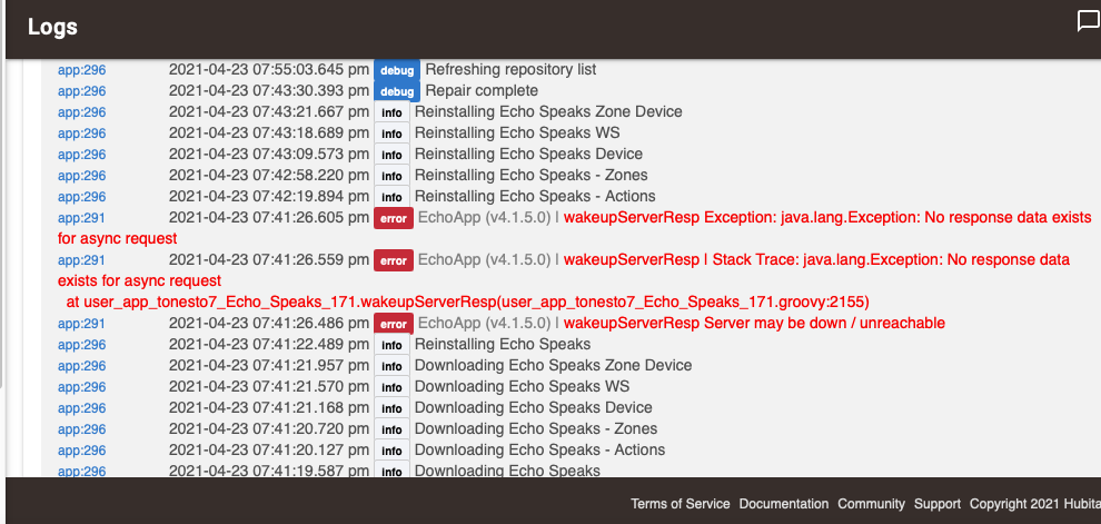

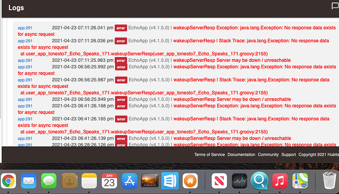

Today I started getting the device doesn't respond after completing a task. (turning a socket on and off, which it did complete) Just a few minutes ago I started seeing this in my logs from Echo Speaks. Everything I've tried with voice control works (7:25 PM).
Here's part of my logs:
This started around 7AM

Well I tried the HPM repair and got some errors.
So the only thing I had changed this morning was the Don't wait for response option as the early messages about "device didn't respond" after completing the operation. So I just went and turned off that option and the next repair was clean.
