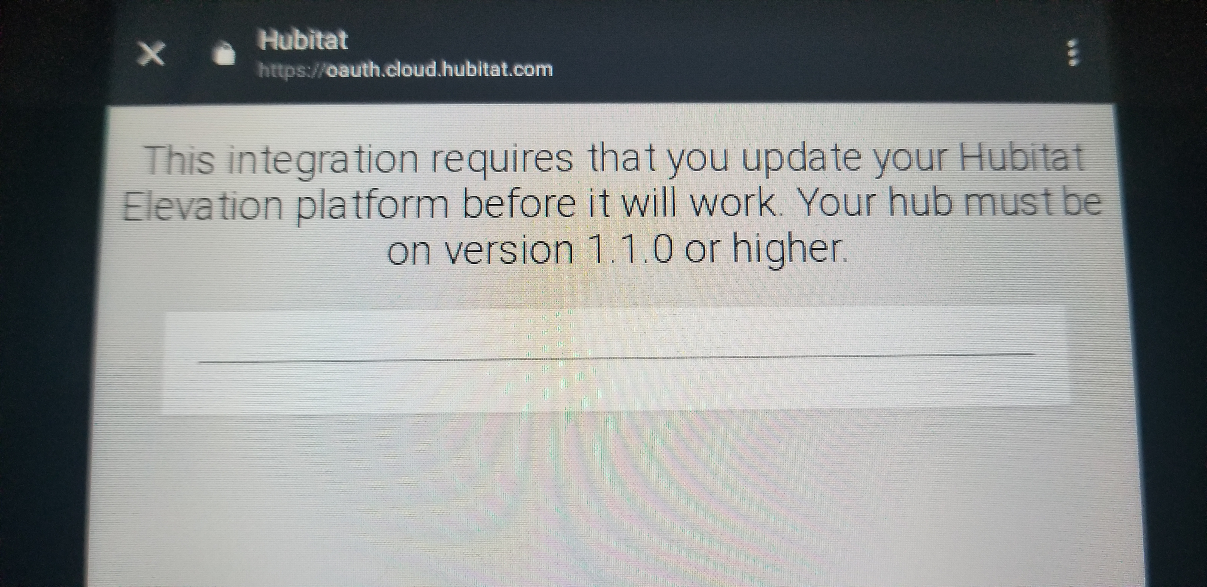

I installed the skill, not the app, when I go to Alexa app in my tablets to add HE I can find the app, I can login, I can select my hub, but I get an error that I must be on version 1.1.0 or higher, I'm in the latest version.
Edit: I tried with the Amazon Echo App and I get the same error. :sob:

Well now Iโ€™m getting this as well. Was trying to reinstall the skill but canโ€™t now.
Me too...everything was showing up Offline, so I disabled the skill and tried to enable it.
Emailed support. Hopefully its something they can resolve.
I did not email support yet. I will do it now.
Tried to fix by removing and enabling the Hubitat skill skill bit know can't enable the skill due to the hub version error message.

It should now be fixed. I was able to add the skill this morning.
I can confirm it now goes to the next step, but Alexa is not discovering any devices. Can anyone confirm?
